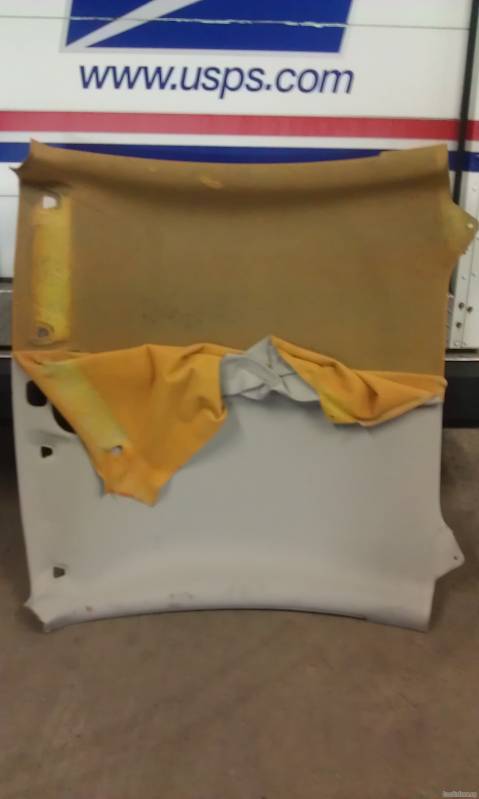

Easy to get loose, takes a little coaxing to get out of the car. I followed Les' instructions and took it out the passenger door in the same orientation that it was in the car. It is simply a glorified cardboard piece that can easily be stripped, prepped, and recovered. Although, make sure they use strong adhesive and plenty of it, because the curves in the liner make the material really stretch into place.
I did mine in CF and love it. I was worried a dark color or pattern would make the interior feel confined, but it does not.
A few pictures for you...
