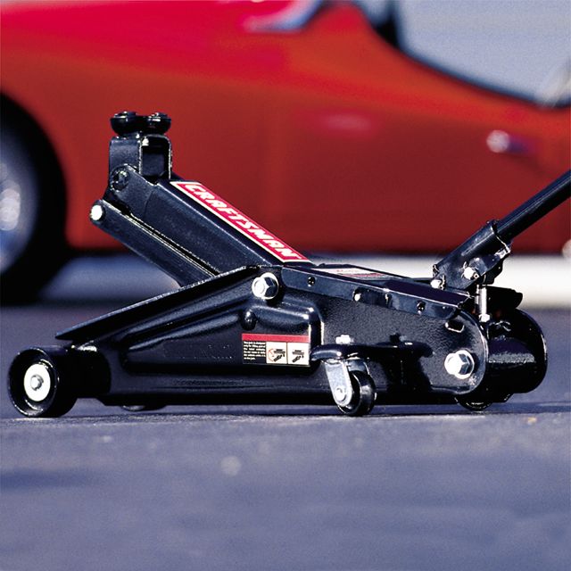

I don't ever worry about lifting the car. My insurance provides free roadside and towing...
I don't ever use the onboard jack. I have a Craftsman 2-1/4 ton Floor Jack for ALL my lifting needs!
