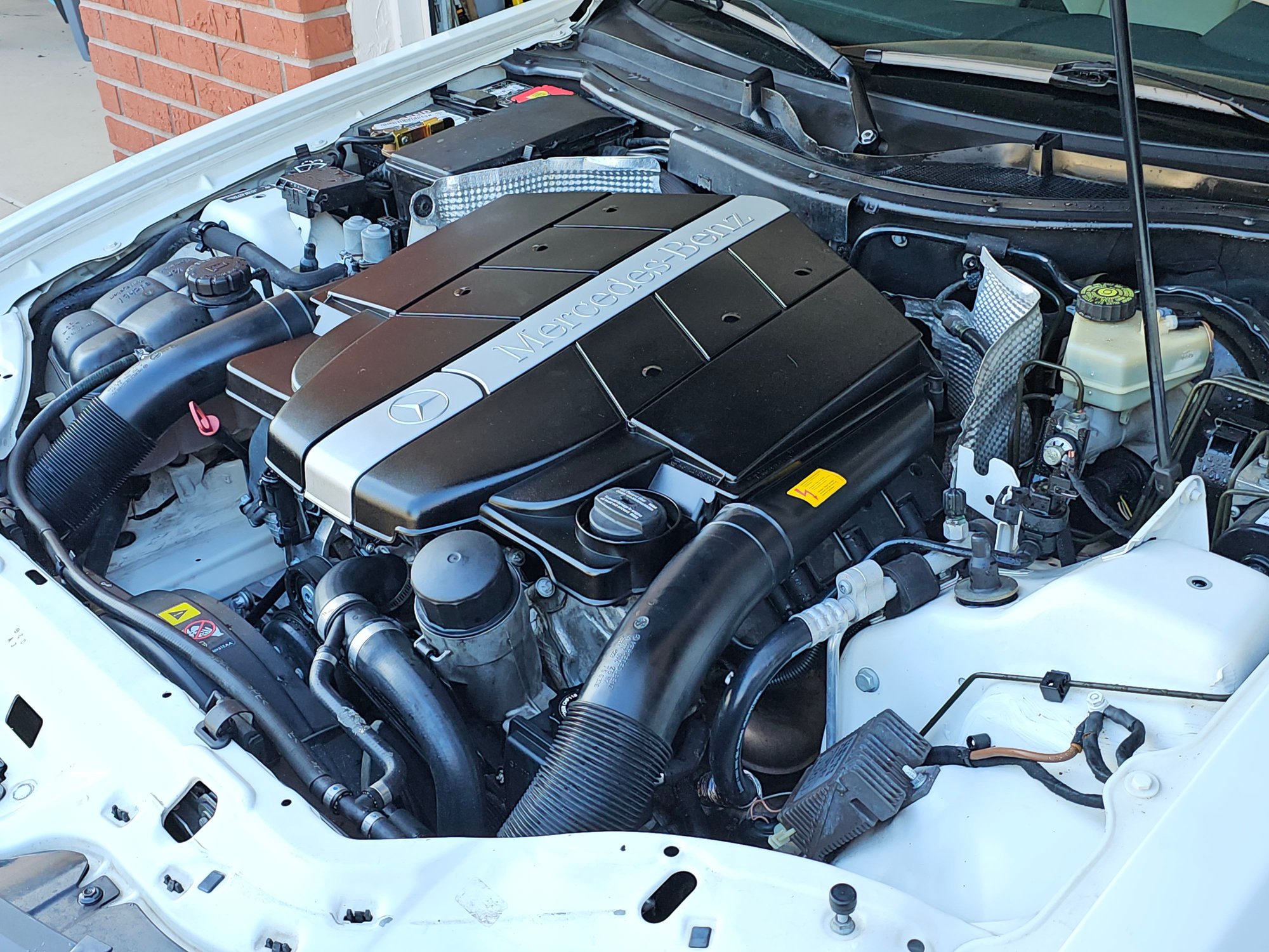

Full view

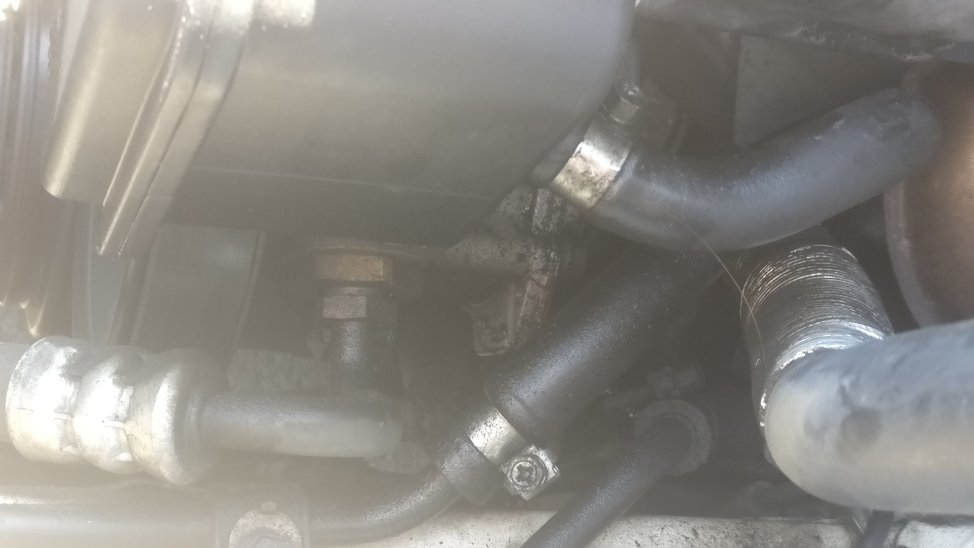

Hoses and leaked fluid view 1
Hoses and leaked fluid view 2
Hoses view 3
Pump
Resiviour does not appear to be cracked. Cap doesn't seem to be leaking. Dont see cracked hoses. Fluid is very low, previous owner filled it up before selling.

Wipe it all down and then you might see where it is leaking from.

I found the leak! It is the "return"(?) hose, that goes to the top of the reservoir. Can I get this at AutoZone, it seems to be shaped very specific way. Thanks guys! I found the crack in it about an inch from the hose clamp. While cleaning the area up.

I tried to find one locally, but no dice. If you can wait, you can find the correct shaped hose at a Benz dealer for a 2003 SLK32. It's about $10, as opposed to the $32 wanted by Chrysler. I could not wait, so I bought some transmission cooler relocation hose from Autozone ($8), as it is the same diameter, cut a piece, and because the radius is so large, you can loop the hose to the existing ports. just make sure it's away from the Exhaust mani, and check that is long enough to not flatten when the engine moves.
