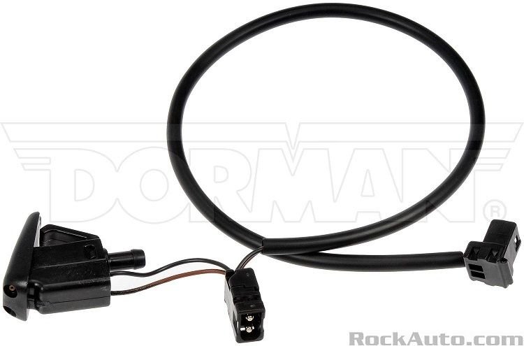

It looks like you can disconnect the hose. If yours has wires, you could probably push air through from the connector or use a large syringe and push vinegar through it.
Here's a picture of the dorman replacement nozzle.
I bet it's just clogged at the front nozzle piece so I will try to fix that first. If I really can't figure it out, might be time to pay the $100 (or hit up a junk yard) to purchase assembly, hose, connect all in one. Thanks for your help!
