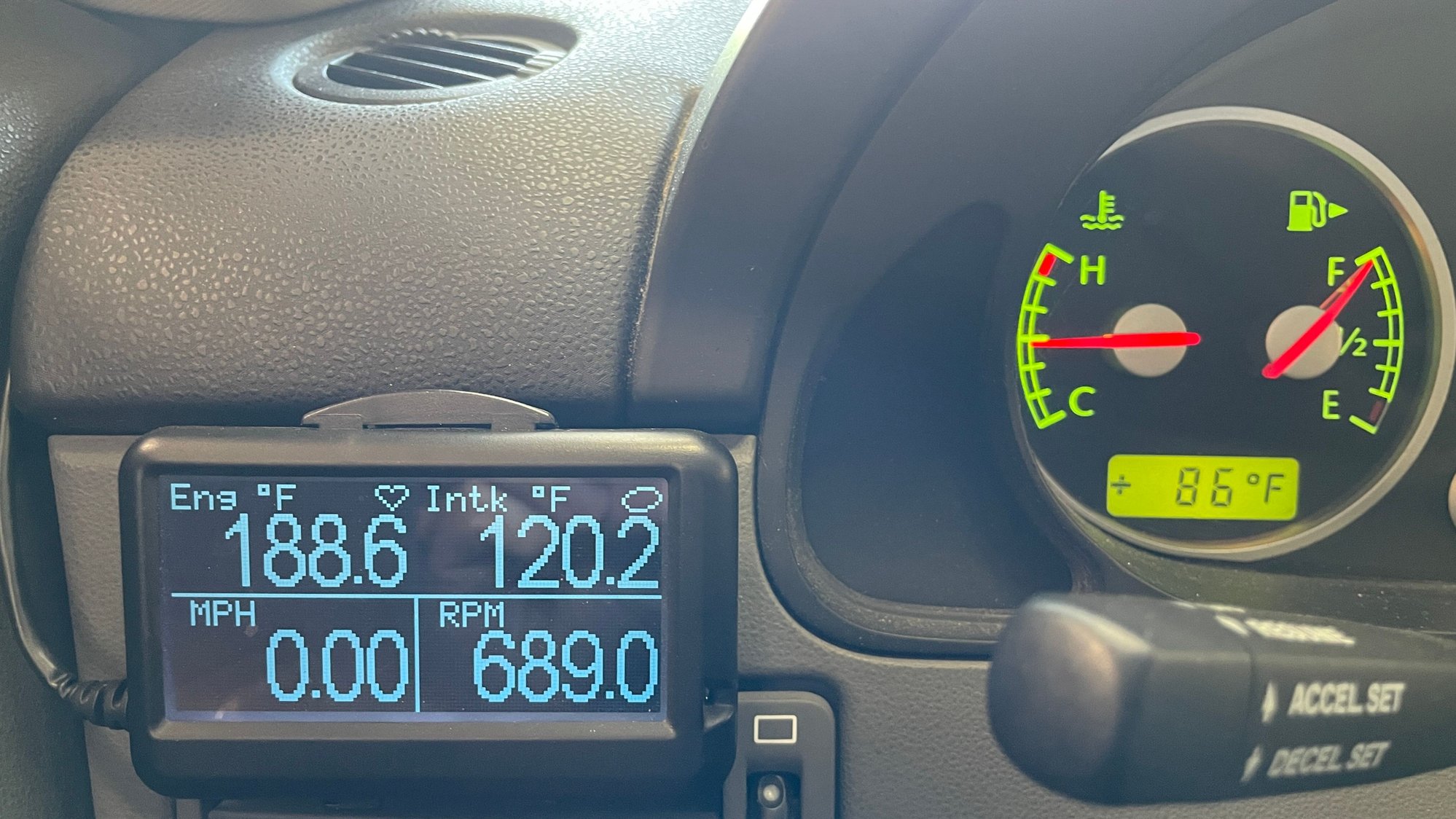

This is a very normal temp during normal driving conditions in the summer
If the temp gauge rises slightly above the halfway point that is still normal too and your actual coolant temp will likely read about 205F which is still fine
I have this Ultra Gauge plugged into my OBD2 port all the time to monitor the gauges you see displayed here
