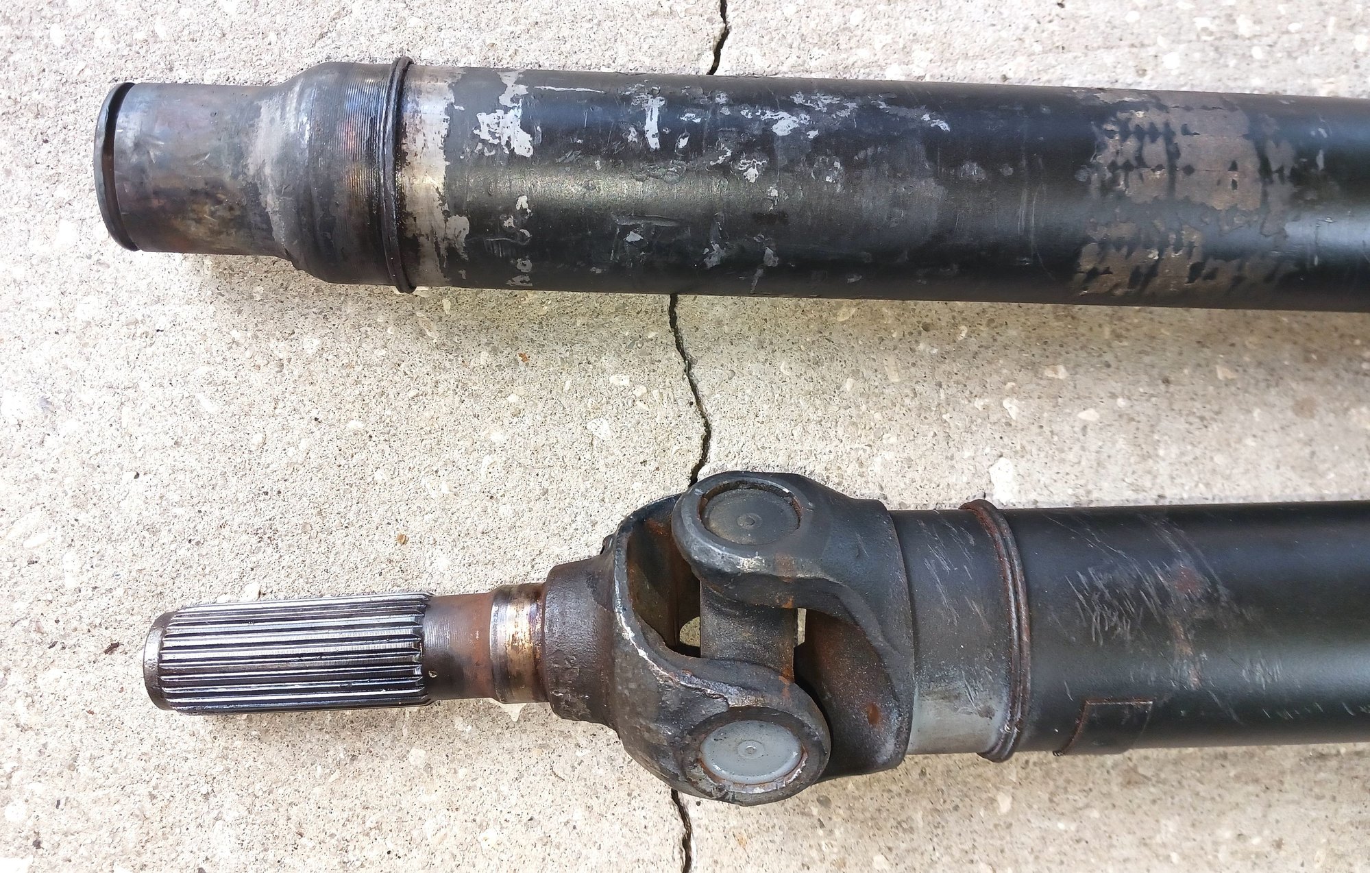

Finally got the driveshaft apart after three days of trying. Took it to a repair garage and they got it apart for $50. He said it took a "lot" of heat and a big hammer as it was really rusted together. Best $50 I've spent lately! So tomorrow I'll be putting the driveshaft back in and hopefully I'll be done with everything underside! Shocks seem ok. Don't know what it would have cost me if I had not done the work myself. It should ride lot better now that the driveshaft can flex up and down. Things I've done underside are:
1. Replaced the tie rod link assembly
2. Replaced upper control arms
3. Replace Ball joints
4. Replaced Center support bearing.

I would not put too much stress on it. All that heat probably made it a bit brittle.

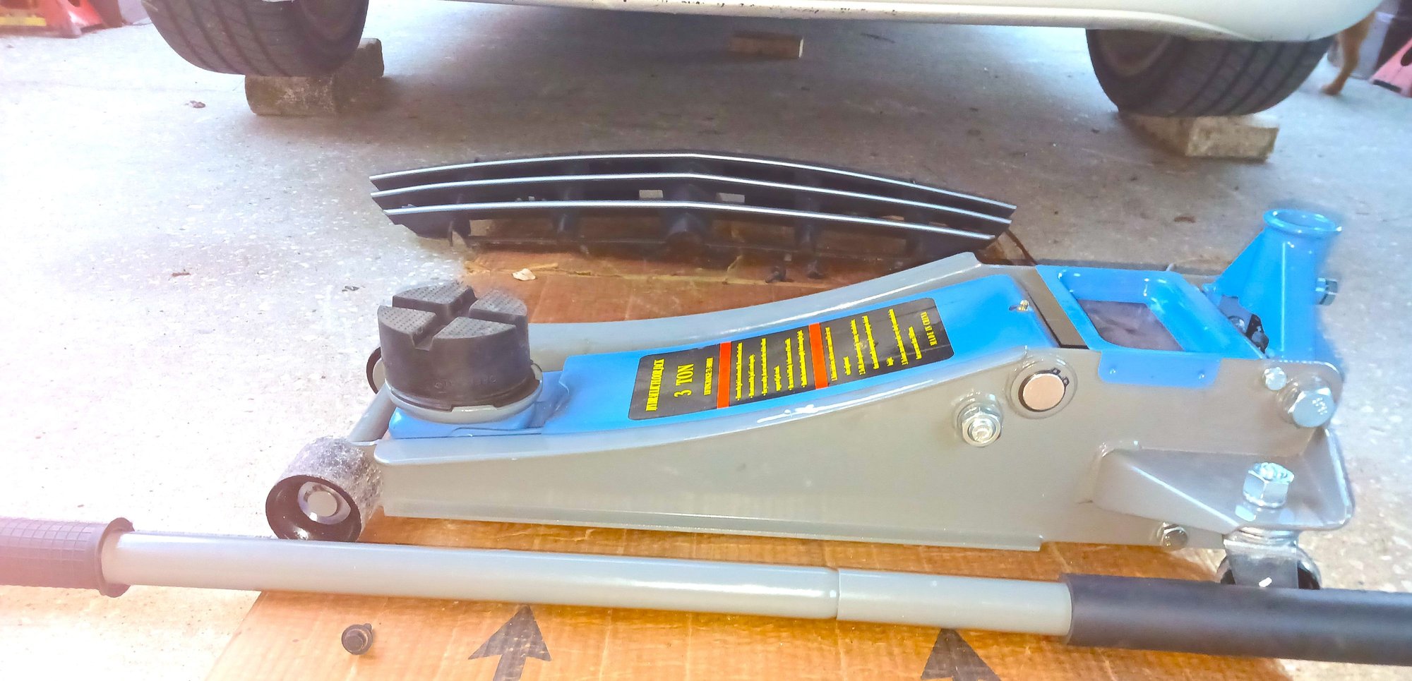

Here's a hack that's new to me but I'm sure quite common. I bought a new 3-ton floor jack because I got tired of using my little 2-ton that I had to stack 2x4 wood blocks on top to raise it high enough for jack stand use. The 3-ton would not fit under the bumper so as to lift in the middle of the cross member. I just drove up on two bricks under the tires and the jack slides right under. Life got a whole lot easier
