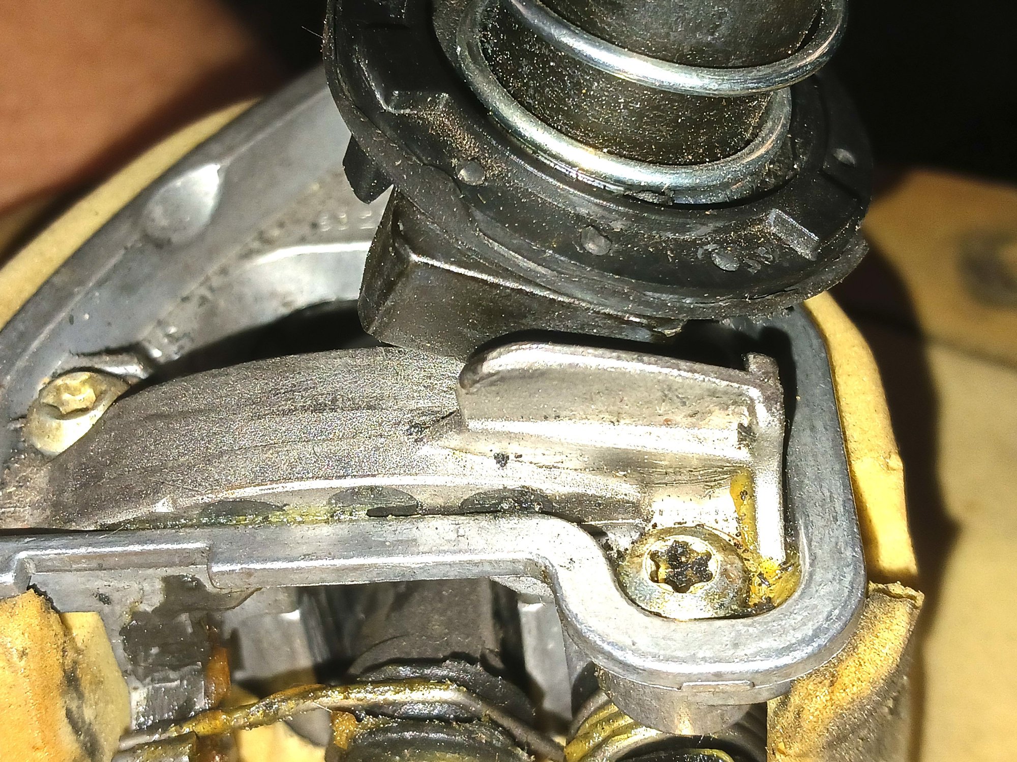

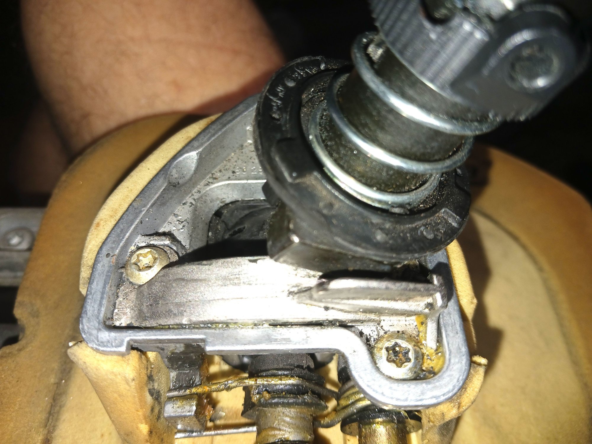

Studying my new/used shifter I "think" I may have found out what's wrong with 1st to 2nd. There's a plastic on the shifter that may be broken and letting the stick go to far to the left. One pic shows a metal ramp that the plastic part rides up on when shifting to reverse gear. Otherwise going from 1sr to 2nd the plastic part rides next to the metal ramp. If that plastic part has broken that would give me the problem I'm having.
Top pic is 1st gear. Middle pic is reverse. last pic is 2nd gear. Maybe the metal guide is loose or out of adjustment thus needing the Miller tool 9120. Also the reverse cable may be out of adjustment.
Notice the plastic shifter part is on top of the metal guide for reverse. That's why you have to "
lift" the shifter to go into reverse.
Notice for 2nd gear the plastic part rides next to the metal ramp.

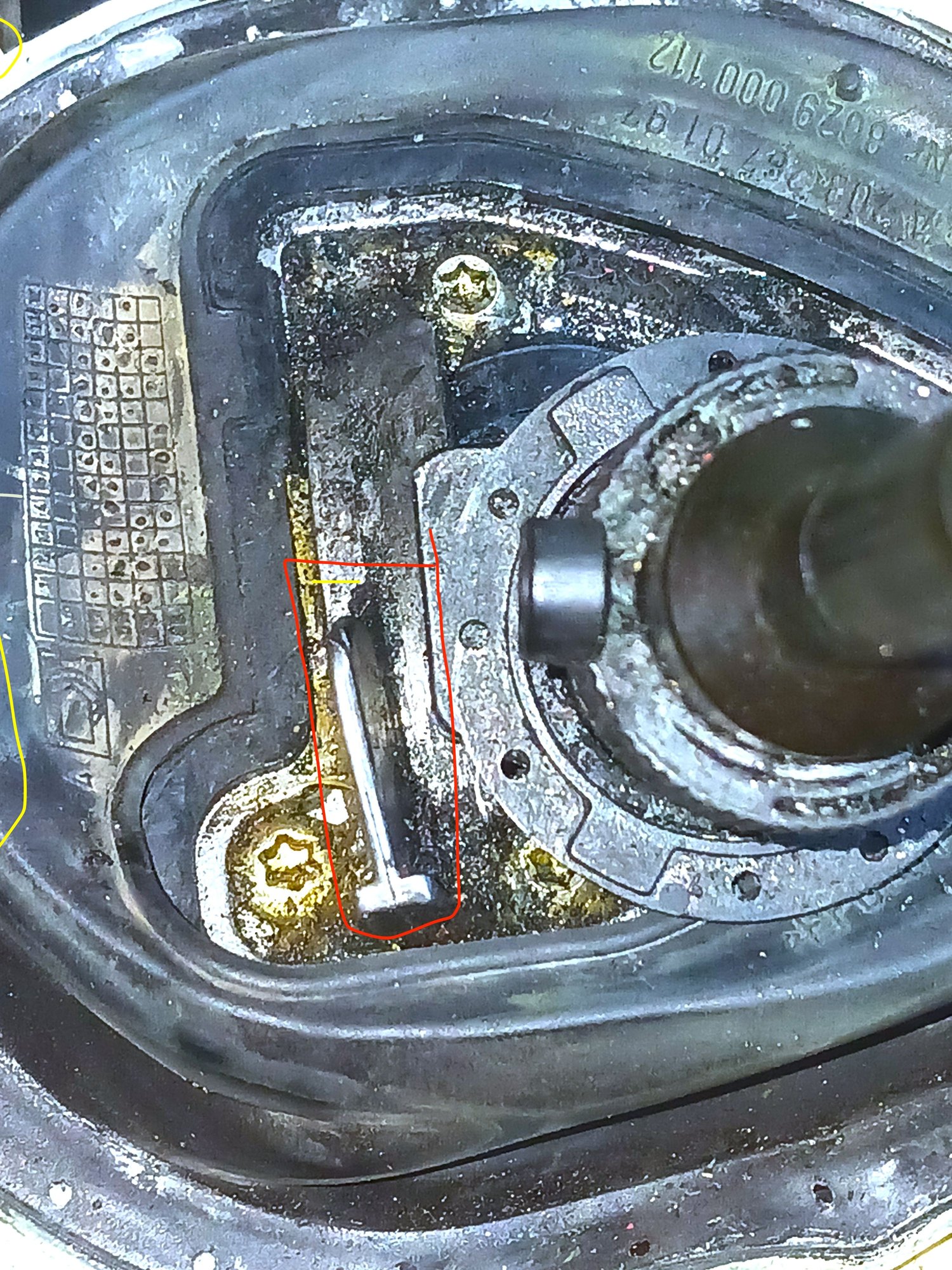

Took the boot off my shifter and took a look. Found an understanding of what's going on. You'll see in the picture, the shinny wear mark, where 2nd is too far right of the alignment rail, aka same as the reverse lockout rail, by about 1/4" and is why I keep hitting 4th instead of 2nd. The rail is held in place by four screws and I don't think it's made to be adjusted. I don't see any slots in the rail holes where it could be moved. So now I figure it's either shifter wear or has something to do with the reverse cable adjustment. When I make the Miller Special Tool 9120 i'll check adjustment of the reverse cable.

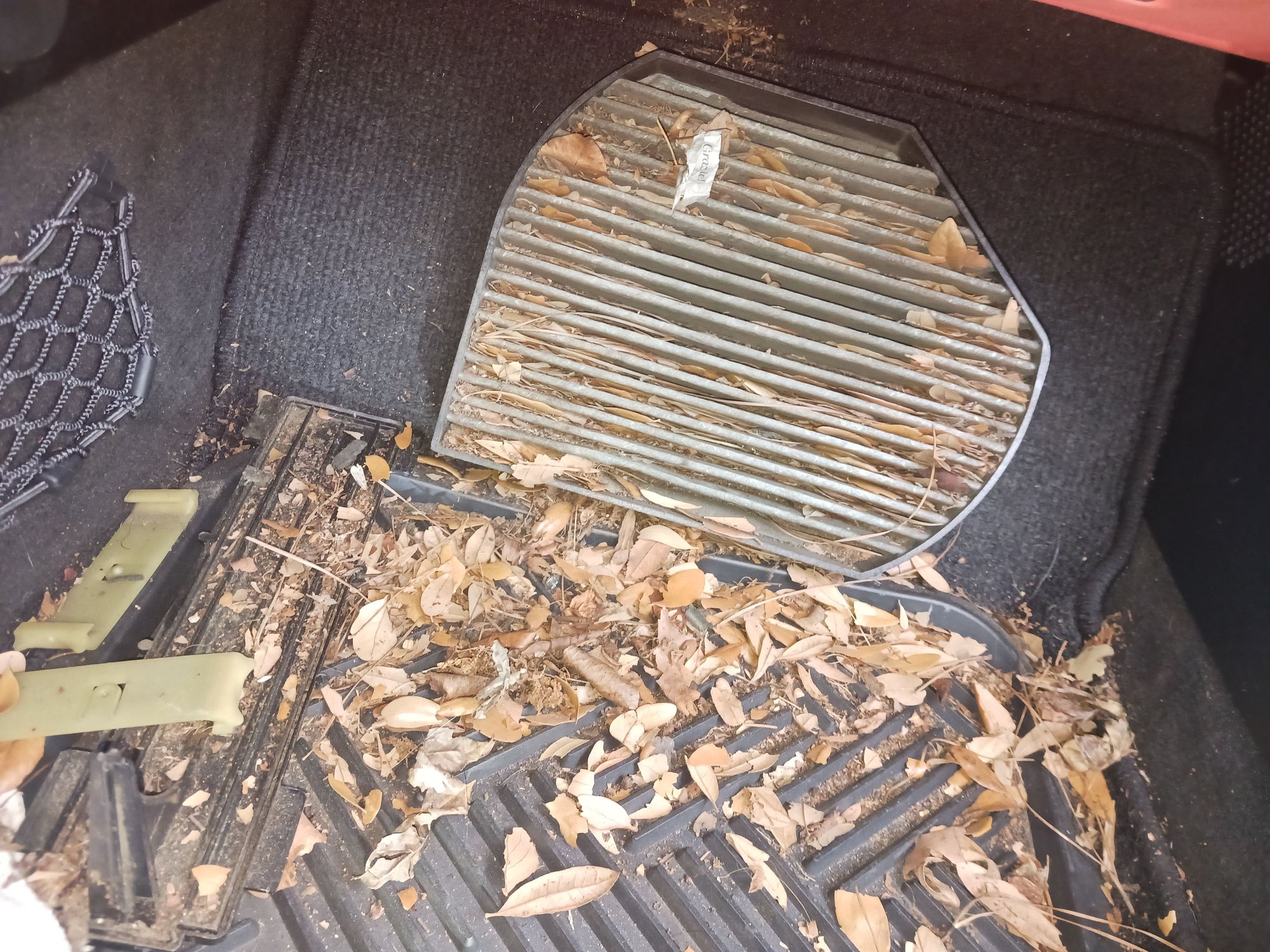

Changed the cabin air filter this morning. Do you think it was time to change or maybe wait 5 or 6 more years? I had already cleaned under the cowling, last week, when I removed the security alarm module. No more dying battery.
