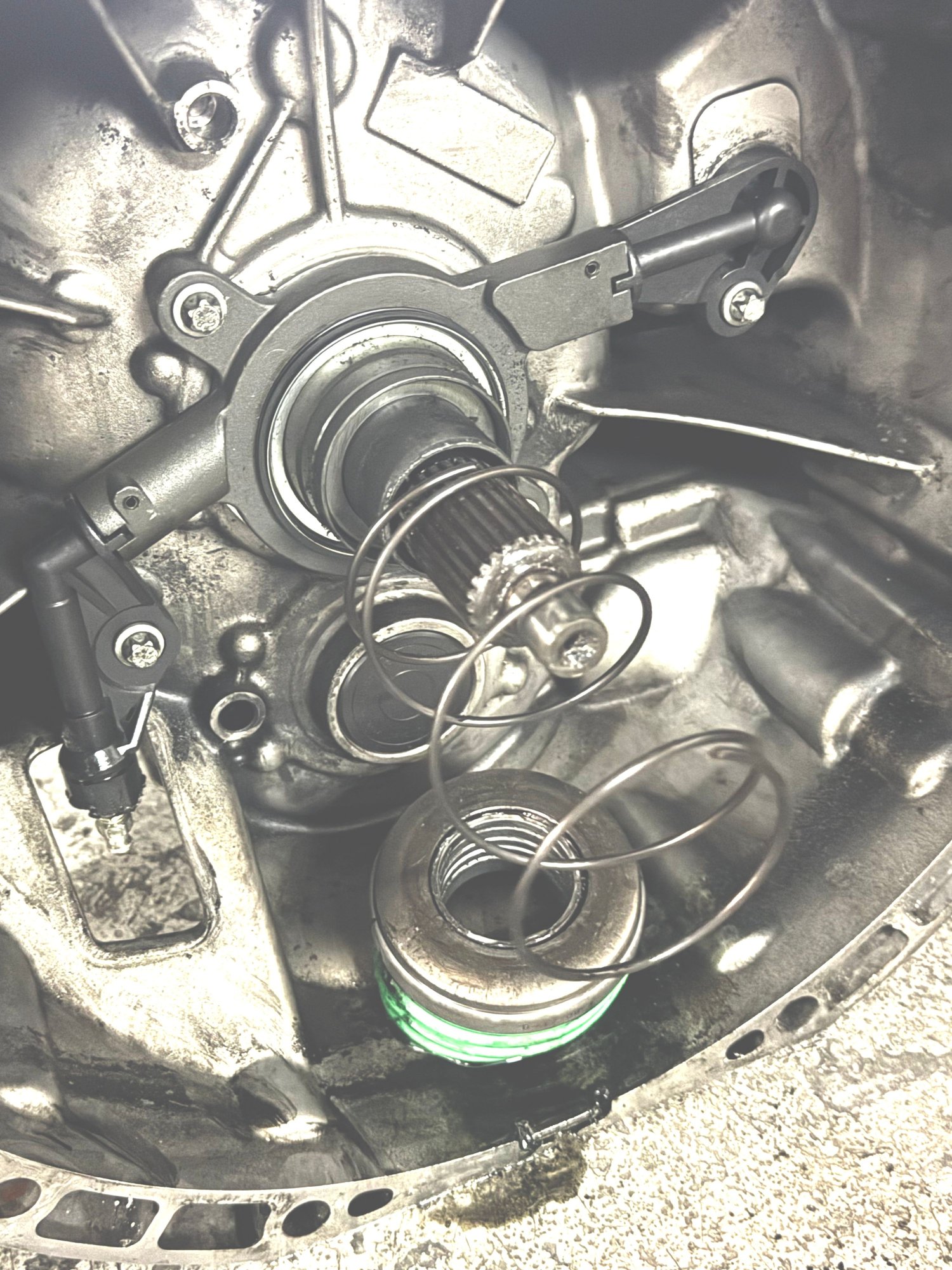

"FIRST DRIVE" this afternoon! This stick shift car screeems. It's nothing like my automatic Xfires! There is something going on with the clutch though. It wants to grab all of a sudden at the top. I'm thinking air in the master/slave cylinder or the wrong relase bearing was installed. There is also a slight hesitation when first acceleration. Don't know what's up with that. Maybe a vacuum leak somewhere.
Interesting pic hen the former owners mechanic was doing the engine and tranny swap.

I would try flushing the clutch fluid, just in case there is air in the slave cylinder. That's the easiest and least expensive way to start.

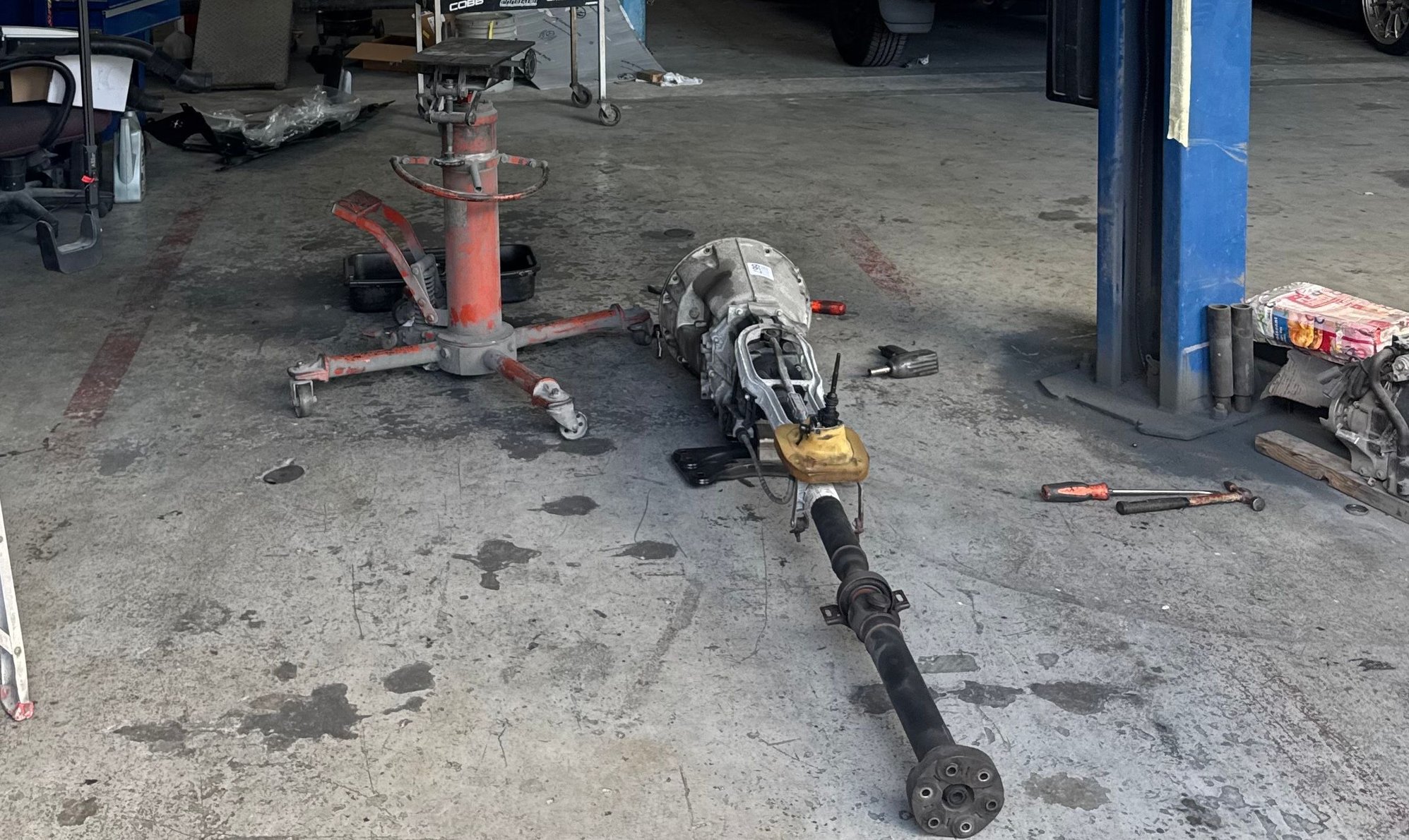

"Everything"just went south on this great deal! Took it for a second drive and found some faults with the 6-speed transmission. The shifter is "loosy goosy" and had to try several times to go into reverse. Hard to shift thru the gears and not snapping into the proper shifted gear. Not grinding just missing gear changes. I'm "guessing" worn syncro problems. Don't know all the in and outs of these trany's. After dong some research on used tranny's i my as well turn this into a parts car! I'm "stupid enough" to try a rebuild but that's looking at $1500.00 plus "if" I was able to do it myself. At the tranny's rear is a tail shaft assembly with shifting linkages. Don't know how much a worn out shifter could create. Transmissions just aren't in my simple brains knowledge base. Anyone have any suggestion for me? Thanks
PICTURE IS FROM WHEN THE FORMER OWNER'S MECHANIC SWAPPED OUT THE ENGINE.

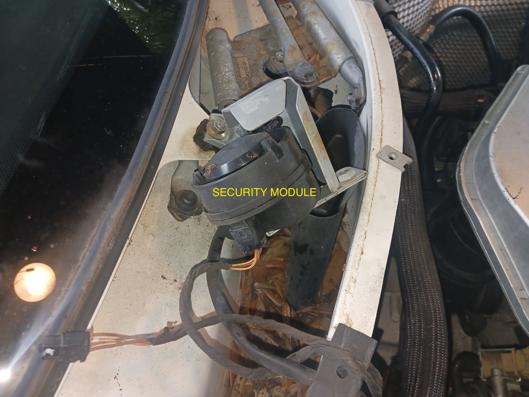

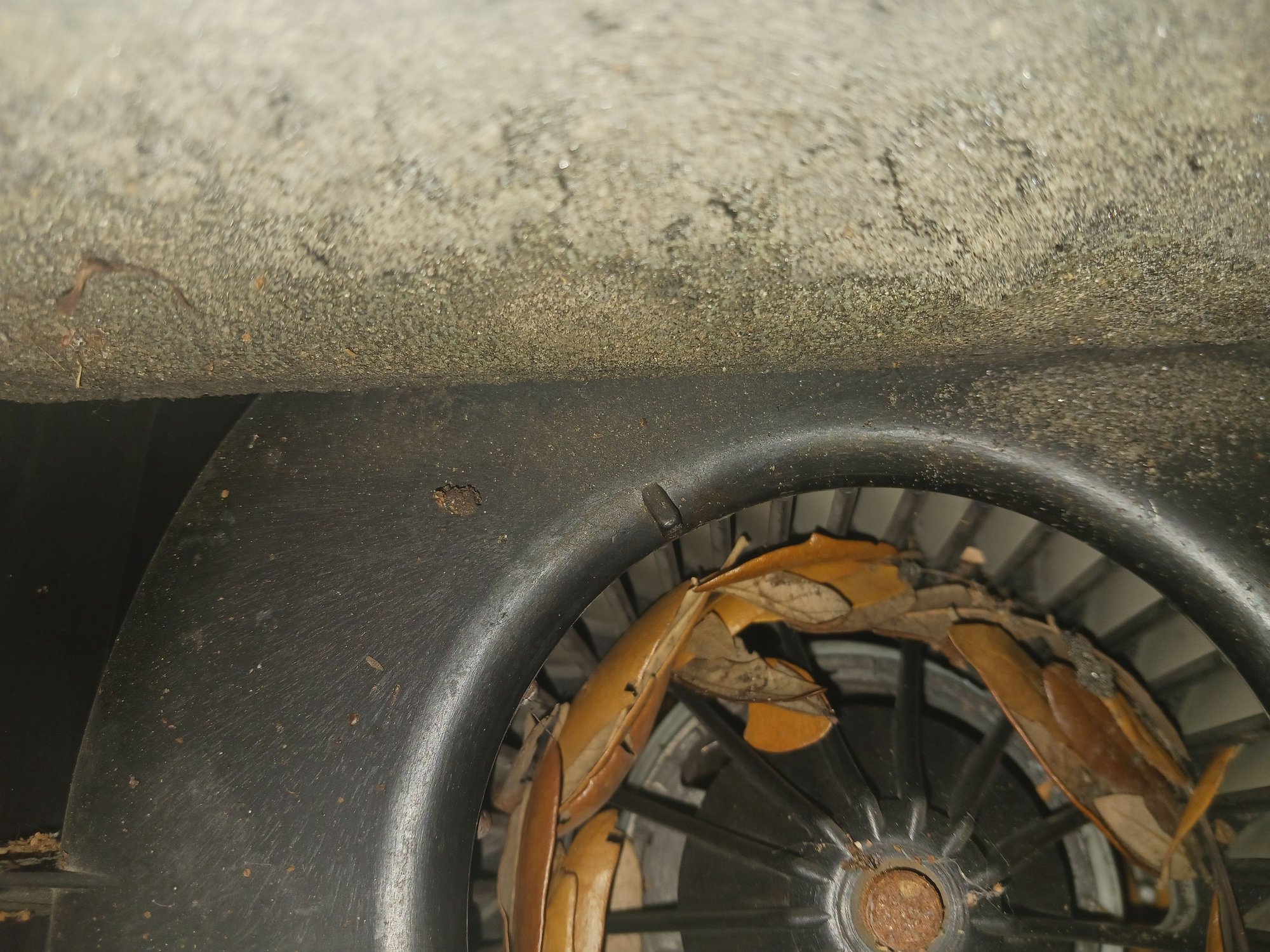

removed security system module under the cowling that was causing a battery drainage. Don't think cowling had "ever" been removed to clean leaves and unblock water the drainage holes. Can't belive i closed the hood with the wiper arm sticking up! You guessed it, i snapped the arm off and will be a $40 mistake. Foiund soo nany leaves in the cabin squirrel cage circulation fan. Next i drilled a vent hole in the back of the driver's head light to let moisture evaporate. Seems to work fine removing moisture now. I'LL CHANGE THE CABIn FILTER TOMORROW. ( That will make an interesting pic! }

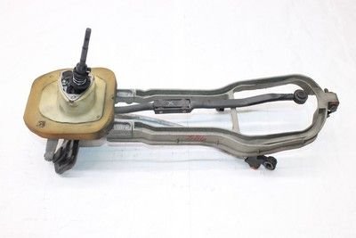

My replacement $420 shift linkage assembly arrived today. Have to make a judgement call wheather it's the tranny shifter problem or is it bad syncronizers! Guess i have 30 days to figure it out to be able to return it or not! Probably have to seek out a "real" mechanic to troubleshoot the problem. I do know the reverse lockout is out of adjustment.
From what I can ascertain from the Service Manual, there are no adjustments to the shifter assembly except for the Reverse Lockout. Probably going to mean the tranny syncros are worn as the car has 170K miles on her. When cold it shifts sorta ok but once warmed up it's difficult to go from 1st to 2nd as it wants to go 1st to 4th gear. Don't think I like fishing around for gears. Buying another tranny is not totally out of the question as I bought the car at almost scap yard price. It would really be a lot of hard work for me to pull the tranny in my driveway laying on my old 78 year old back.
