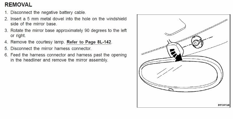

Who knows what kind of tool needed to tighten the interior mirror? I can't twist my neck and head to see inside the two holes of the mirror. Don't really want to replace it but rather just tighten it up so it's not floppy! I added an "over mirror" with dash cam on the OEM mirror.
Here's a link to a thread I found on how to make the mirror tighter: Rearview mirror

Thanks I'll give that a try. Seems like such a weird attachment for a mirror! Once removed I guess I'll have to crimp on the spring attachment to tighten it up. Appreciate the help!
