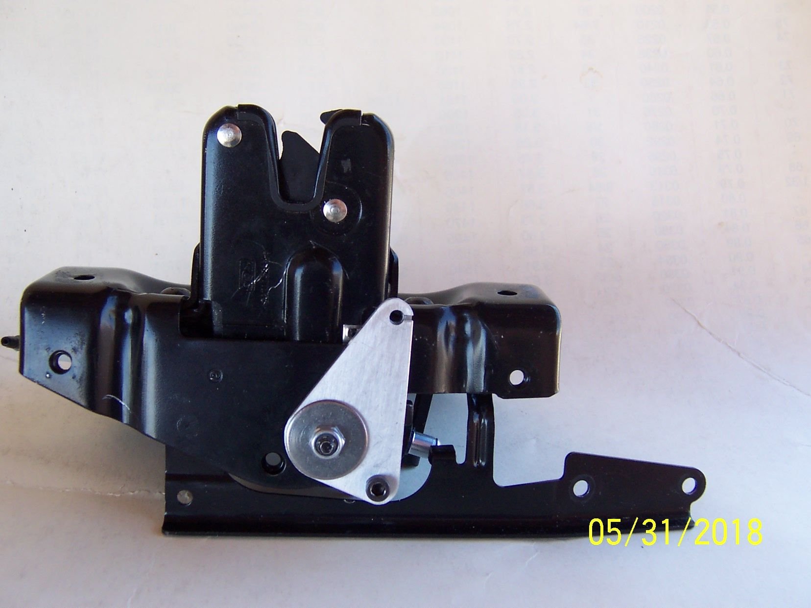

After a few months of probing my deck lid with J hooks and screwdrivers, I finally got it open with the aid of an endoscope and a good screwdriver, My latch mechanism had a "double whammy", with a broken pivot and a broken emergency release lever. I was able to repair the pivot with a metal core, and would show a photo of it, but the pics don't reveal much of the repair features. I can supply details to anyone who PMs me, though.
Replacement of the emergency release lever was easy, and the accompanying photo shows everything. The lever itself is 5/16 inch thick aluminum, and a metal hub and hardware secure it in place. The lever mates with the original cable and fitting that link it to the 'glow in the dark' release handle. I also added a cable that is accessible in the LH license light mounting hole, to provide rapid opening of the trunk if the pivot fails again. Here's a pic of the release lever - I don't think this one will fail!
Thanks to all who have contributed to this thread and facilitated my repair of the deck lid latch!

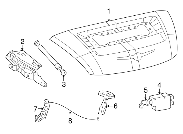

Put in the fix from Pizzaguy and found a broken piece floating around in the lock assembly. Part # 7 is broke and I was wondering what the part number is and where can I get one? I am guessing quite a few people have the same problem I do. Has somebody come up with an alternate way to get around this broken piece for the emergency trunk release?

The plastic piece, find 7, in thread # 187 is broken. How did you make the connection between the trunk latch cam and the yellow pull tab? My broken piece #7 will not allow that to happen. I have not got to the point of checking the cam you are talking about yet. I just found the broken piece on the trunk floor and determined where it came from. Tried two types of glue with no luck and ready to go get a two part epoxy and try that. I doubt that will work either.

In Post #181, I have replaced the OEM Part, find 7, with a roughly triangular aluminum plate, which rotates about the shaft that the original part was mounted upon. Referring to the pic in my post #181, the emergency release handle is connected to a cable that leads to the original find #7. That cable attaches to my aluminum part in the same way, at the top of my part.

A neat solution to the problem and nicely made, well done.

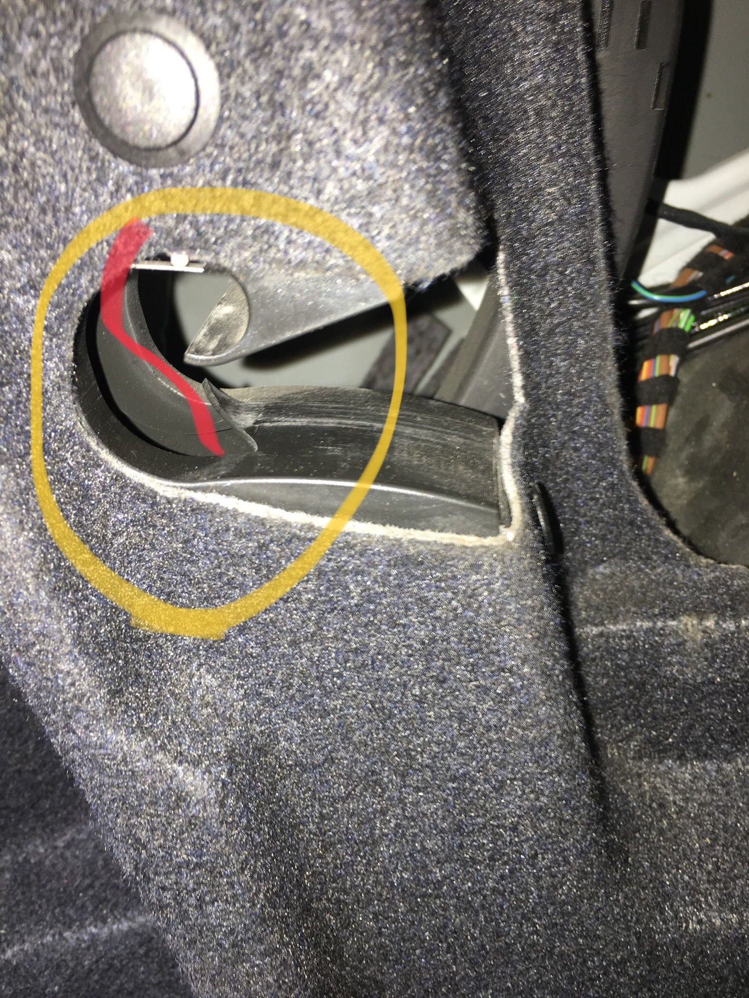

This post is a gift that keeps on giving. I sort of inherited a crossfire from my wife's uncle a year ago and I love it. The hydraulic lift cylinders did not work when I got it so I have just been putting the top up and down manually. It worked fine until I accidentally hit the "top up" button while it was down. It did not go up, of course, but it did leave me with a trunk I could not open. This post and the threads around it saved me untold grief by explaining what happened. Plus, it pointed me to the solution as I managed to disengage the electric lock through the right side license plate light (per this video
). THANKS TO ALL WHO CONTRIBUTED TO THIS!!!
