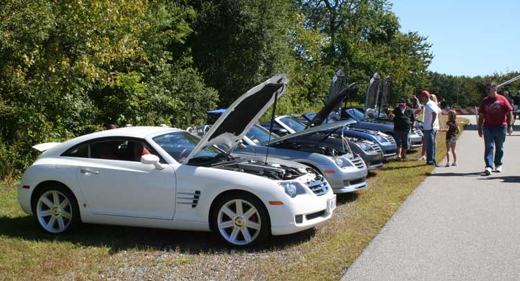

Originally Posted by RKC00
Full vertical with the "right" assembly... cars towards the end of these..
Old Feb 3, 2017 | 09:52 AM
Likes: 650
Default Re: Hood support
Whenever I raise the hood and it will be left raised for a while I always raise it to the vertical position. I think that takes the strain of the internals of the cylinder and helps it last longer.
I maybe right or wrong but it cannot do any harm.
