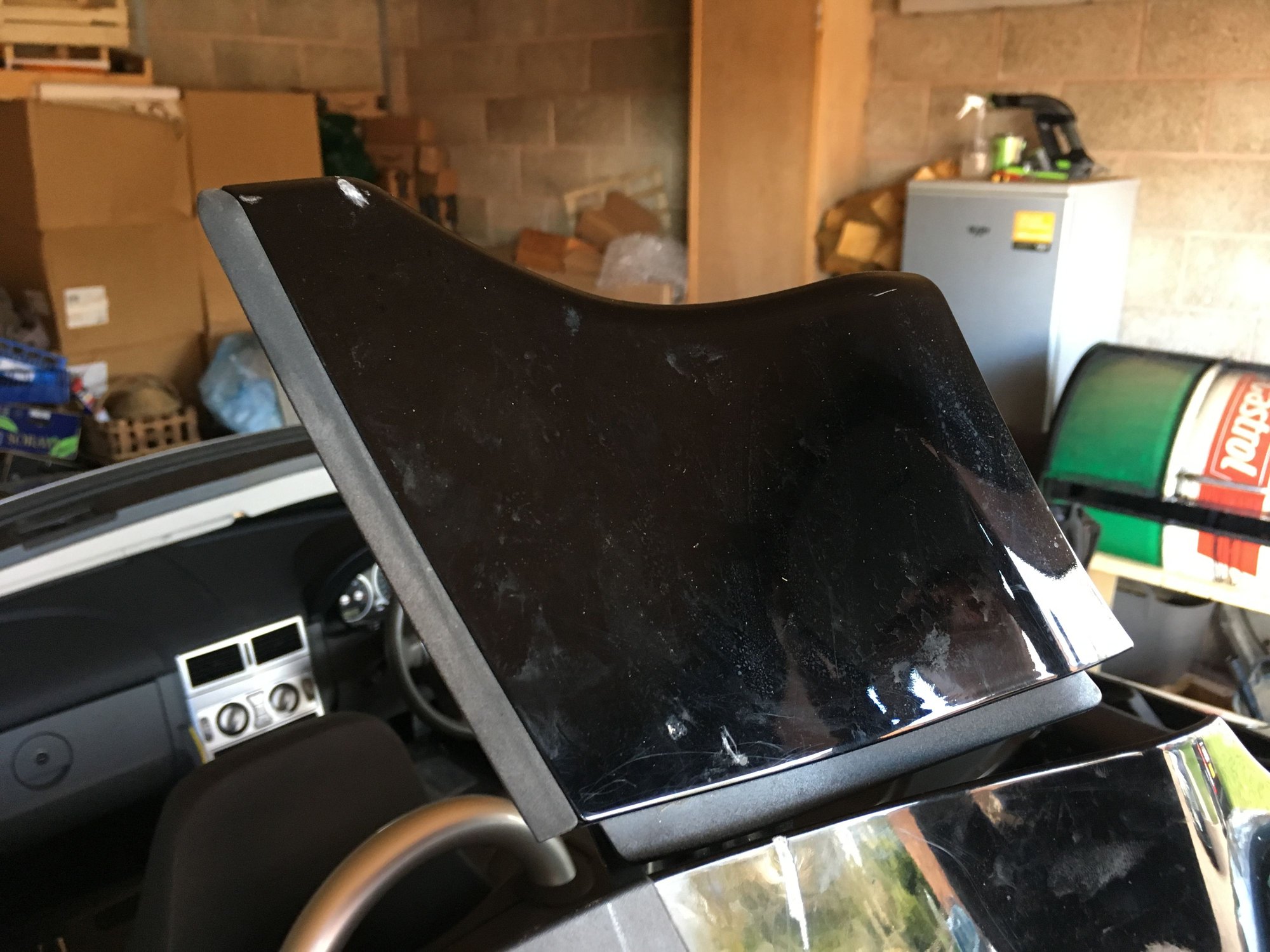

Hi all, please help if possible.
Just bought a 2005 Roadster, but the roof does not operate.
The switch in the centre console flashes red. I can open and close manually ok, but when I do, I noticed that the 1 of the 2 pieces of the hood cover does not operate as it should (See picture)
The passenger side flap does not move when the roof is manually put up and down, the Drivers side flap moves up and down in synch with the roof.
Could this be my problem, a sensor perhaps?

There is not any sensor on the flap cable, they simply operate as part of the mechanism. A flashing red LED in the switch usually means:
1) The cycle did not complete the last time you moved the top (manually or otherwise).
2) The Top Module sees an obvious problem and is preventing movement.
If you are experiencing any issues with a BAS light, a trunk lid that does not close properly, windows that do not go down when you turn the "D" handle, a spoiler that does not go up or down automatically or power windows that do not respond to the console switches, it can be that such issues are being interpreted by the top module as problems - stopping the top from moving even tho the issue isn't technically with the top.

Why would the passenger side flap not move up and down (as the Drivers side does) when I manually put roof up and down?

Broken or loose cable.

Cable seems intact, how do I go about tightening it?
This is a physical problem with the cable at one end or the other.
It is not intact if the flap is not moving as it should, it is disconnected/broken at one end or the other. Comparing it's physical configuration with the one that is working should lead you down the right path, but this won't make the top system suddenly start working - that is a different issue.
