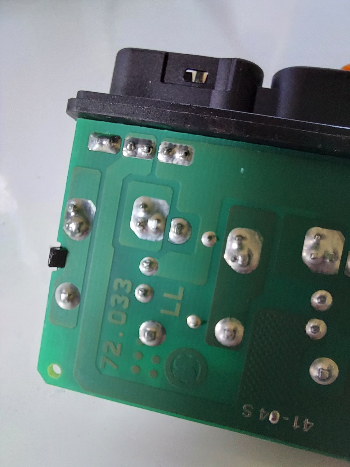

Chief issue us odb ii cannot connect & bas light on, spoiler up and cruse not working. Added additional grounding, no real help. Now looking at rcm, anyone see a problem here? Car is drivable.

looks like there may be some fracturing around that middle connection...

I'd reflow most of the entire board, but I agree with George. Also, know that a sluggish, pitted or bad traction control relay causes, essentially, the issues you mention.

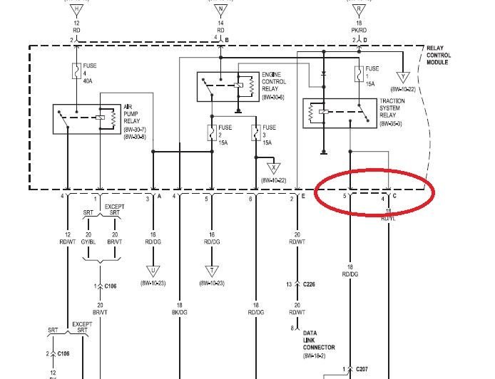

Make sure it's pulling in and you have over 12 volts at the output of the RCM, plug C, pins 4 and 5. (I believe, with an automatic transmission, it won't shift from PARK if this is the issue, but George has an auto so ask him.)
