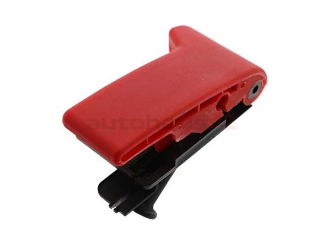

This is a hood release lever for the merecedes slk 320 verify it's the same as crossfire $9.00, The crossfire part # 5096557AB but cost $49 also lube hood latch, cable still available
https://www.autohausaz.com/pn/1248800320
