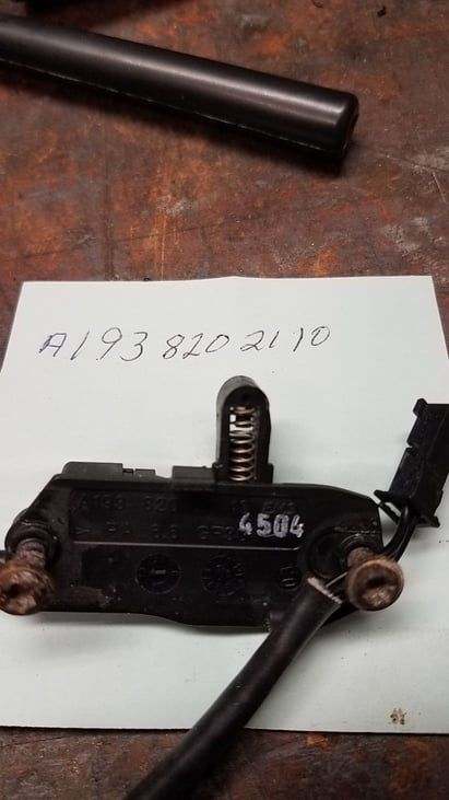

Working to restore powered convertible top operations, I have learned a couple of things today.
The first is the microswitch is a Normally Closed switch design. It closes as you push up on the front of the top after releasing it from the windshield header.
The second thing offends my Spidey Senses(engineering for ease of repair). The Top Open Switch body is molded to the plastic bracket that holds the switch and it's activation sliding cam.
AAUGH!!!!

Hello, I broke this top open switch, do you know how I can order a replacement or how to rig it? Thanks, Jeff
Old Jun 8, 2024 | 02:10 AM
Posts: 3,195
Likes: 1,730
Default Re: Top Open Switch
Originally Posted by vhrules
Hello, I broke this swtich/sensor, do you know how I can get a replacement/ Thanks, Jeff
Here is the part number. I found it on an old post. You can try e bay or an online parts wrecking yard.

That's it, thank you very much. Wow, $420.00..... Jeff
