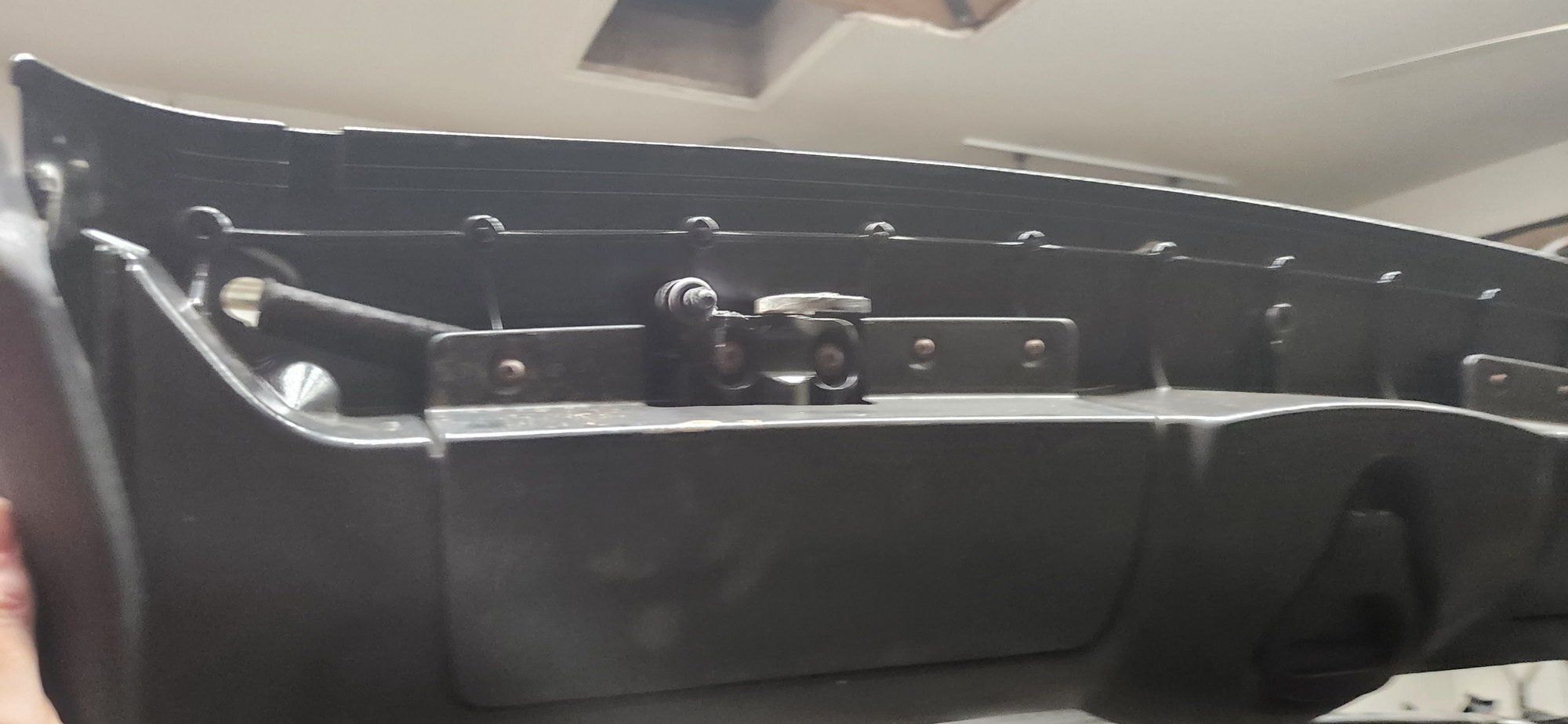

On the inside take off the three bolts on the cover plates and remove. Pictures are in reverse order
You will see the adjustable linkage in there and will give you access to see how the hooks are engaging or not.
linkage across the top
close up of adjustment
remove 3 screws along front edge to access with top on
