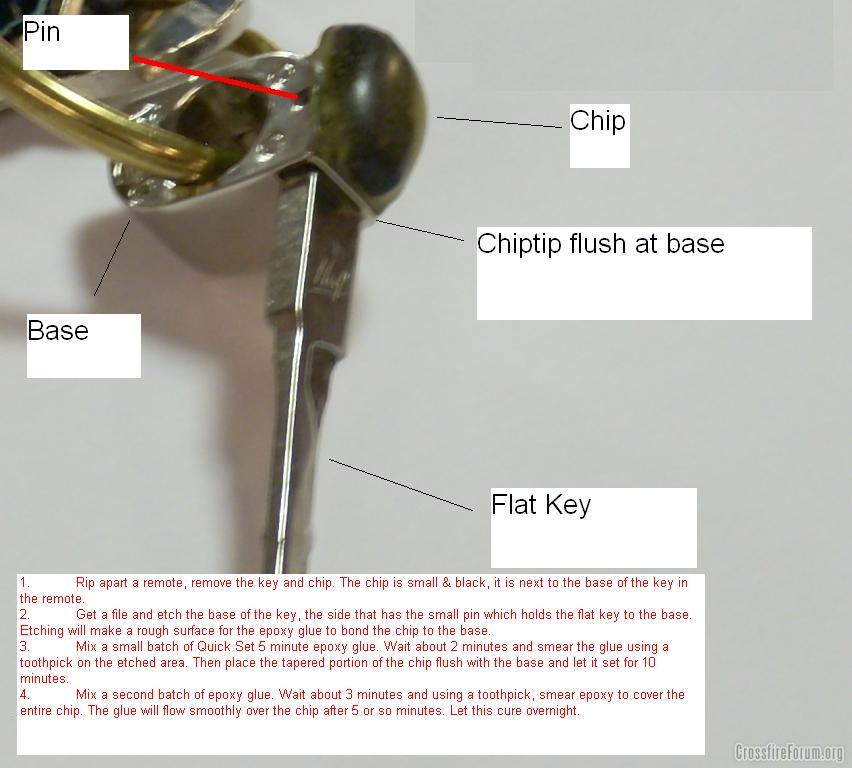

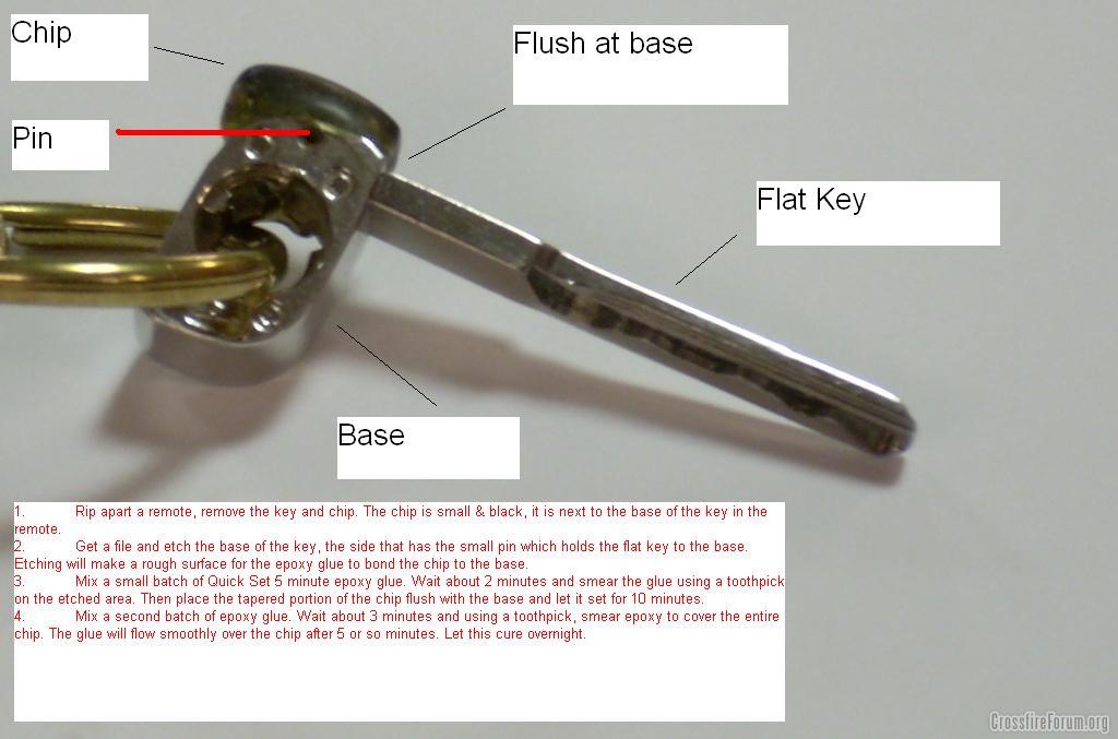

I got the Viper alarm and did not want to carry two remotes, so I took 1 of 3 factory remotes that I received with my car apart and epoxy glued the small chip to the key and have had no problems after a 2 1/2 years.
Shade

This is a DIY project, and afterwards you can attach the key to any normal size keyring. Once you insert the key into the ignition, just turn the keyring to start the car, real smooth and easy to do.
  • Rip apart a remote, remove the key and chip. The chip is small & black, it is next to the base of the key in the remote.
  • Get a file and etch the base of the key, the side that has the small pin which holds the flat key to the base. Etching will make a rough surface for the epoxy glue to bond the chip to the base.
  • Mix a small batch of Quick Set 5 minute epoxy glue. Wait about 2 minutes and smear the glue using a toothpick on the etched area. Then place the tapered portion of the chip flush with the base and let it set for 10 minutes.
  • Mix a second batch of epoxy glue. Wait about 3 minutes and using a toothpick, smear epoxy to cover the entire chip. The glue will flow smoothly over the chip after 5 or so minutes. Let this cure overnight.
Shade

Thanks for the awesome info Shade! I just managed to swap the chip between my old beat-to-hell remote and a brand spanking new (prolly used) ebay fob. It starts my car just fine, which is sweet.
Unfortunately, I can't get it to lock/unlock the doors via remote. I've tried the "insert key in ignition, press lock twice and turn key to ON position". I didn't work.
Any ideas?
