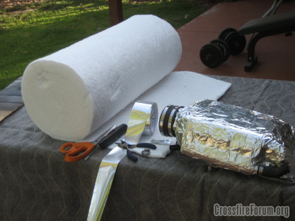

Default Re: MAP Sensor Gremlin at Idle?
Originally Posted by SRT6nTulsa
Here's a stupid question: Is the MAP sensor the one plugged into the "Y" piece?
Nope - that's the IAT sensor
The MAP sensor is mounted on the intercooler core and can be seen belownext to the pliers (little black plastic piece)
