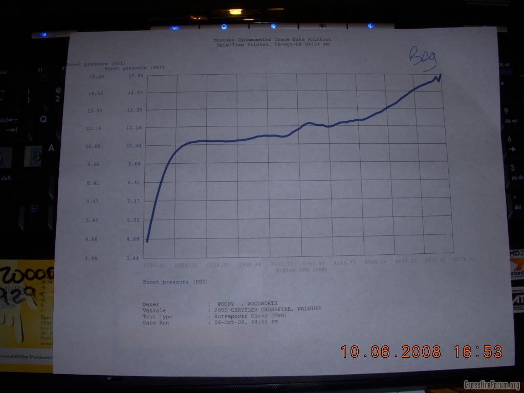

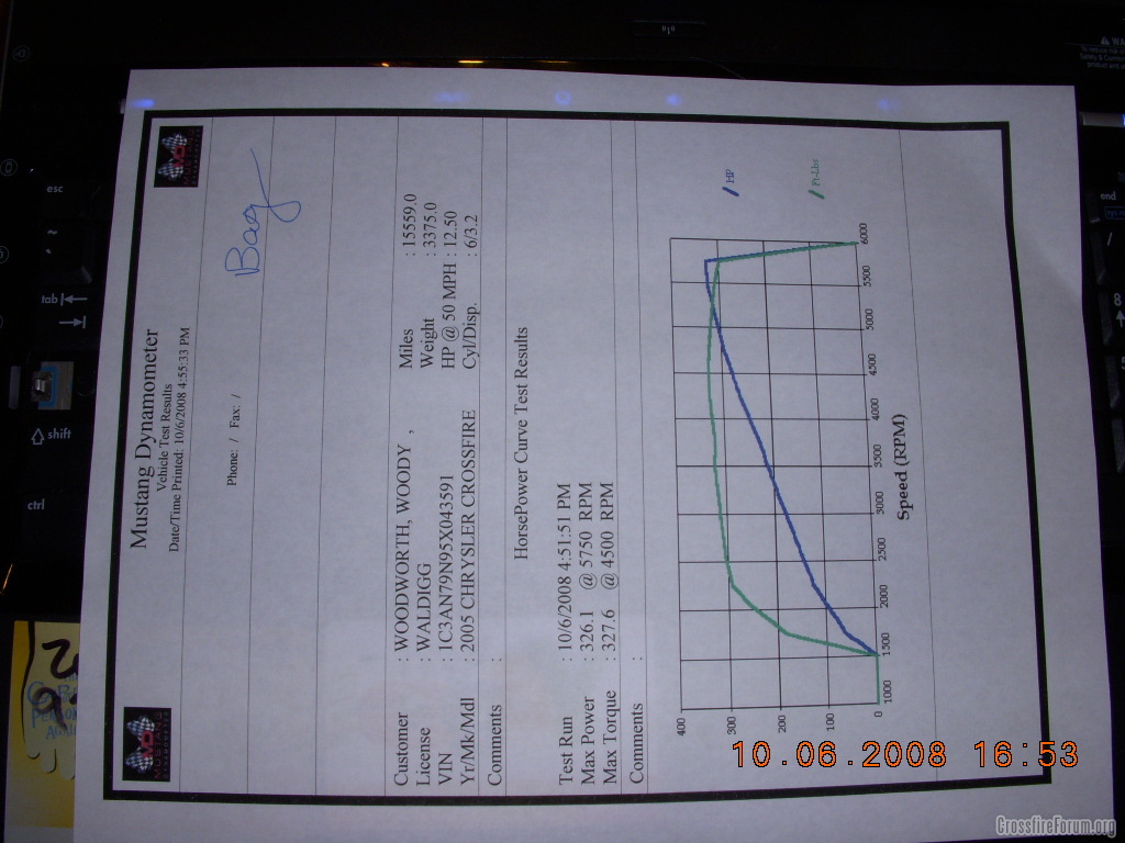

Well I had a bunch of gas used to get good and repeatable numbers but made many runs across the rollers. The quick and dirty info is that:
My code 3 seems to have gained 4 HP, boost went from 14.5 to 15.88 using the same dyno machine.
My horse power total is now 338.5 at the rear using the super cooler for the H/E upgrade. The water never got over 120 degrees in an 80 degree shop ( before the runs).

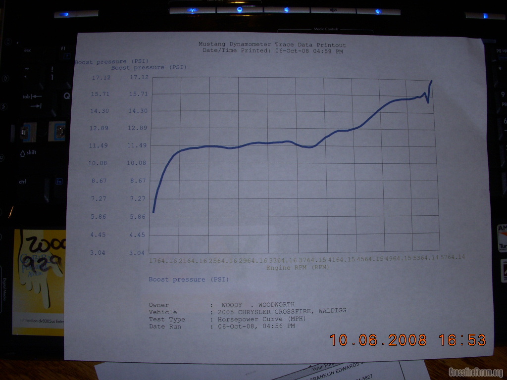

Those coming to see the runs at MIR drags, will see the October suprise which I have been fabricating and testing. This gave me the 12 H/P gain and moved the total boost up to 17.12 with the same pulley. This is a total gain of 16.3 H/P over my previous best pully previously. Bad news is the design change details are restricted and its release date is the 12th of October. More to follow.
My differential pulls are within 5 minutes of each other and it only took me to 1 minute to get the changes completed to prove this upgrade. The charts are below for your review, thats the good news. Horse power gains higher than this are going to be achieved by thoes who have bigger pulleys than mine. With a 185 I would expect about 19 H/P.
The Many runs at the dyno were to get it set up correctly, to get the boost readings working and to be SURE that the H/P gains are repeatable. The code 3 did not get me what I wanted but I report the information as accurately as possible.
ENJOY, WOODY

You can not just look at peak numbers. I charted it for you, as you can see the code3 pulley gave you big gains across the rpm range for both torque and hp. This is not exact since the charts did not plot the same exact rpms but it should be very accurate:

Here is your psi before and after your mod:

The numbers show the Code3 gives a pretty darn good increase on the low end between 2000-4000. At 4500 and up it flatens out to be close to the factory pulley. That matches what was posted on the early dyno's for the Code3 pulley. The crank pulleys see the increase pretty steady from low to high.

I found the original boost charts where the only changes were the let spacers, NW intake manifold, and a gasket matching of the head/intake manifold. Stock boost was up to 14.3 PSIG at full rev range in this configuration.
To overlay the charts the code 3 pulley got a total of 110 #/feet torque increase at 2000 rpm or a power gain of about 20 h/p (120 v.s. 100h/p)
The gain falls off and is about 4 h/p at the 5500 range. This is really strange and the object of my wonder. I did see the chart which lists the gains but still wish I knew how the early jump in torque and power fade so much. That is information, just do not understand it yet.
