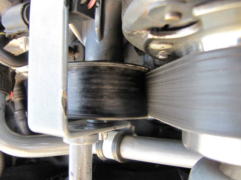

Ok, so after the failure of usability from adding the new pulley and routing of the belt. I figured why not remove the supercharger idler pulley, similar to the design of the pulley saver kit. It does give more wrap than stock, but not as much as having the supercharger idler pulley in place to push the belt down.
I am worried about the addition of the new pulley above the alternator. I will be looking at getting a bracket made up, but will running it like this cause more stress on the bolt of the added pulley as opposed to when the stock SC idler is in place as well?
Here are some pics.

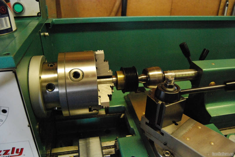

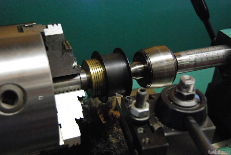

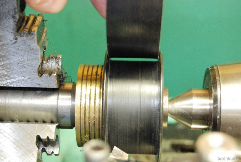

I have the NW pulley kit on my Aero so I had the factory SC idler on the shelf. I decided to see how hard it would be to turn it down on my lathe. Here are pics of it setup, turned down and with the belt set in.
This was not too hard, just a PITA since I didnt do any tooling to hold the part real tight to the head stock. I just put it up between centers and used friction. That means I couldnt take very big cuts or it would stop the part from spinning. After I cut down all the ribs, I had to open up the channel so the belt would sit down in the bottom. The finished diameter is 2.2" or about 56mm. That was cleaning all the ribs clear. Kind of looks like a spool for a fishing reel.......
