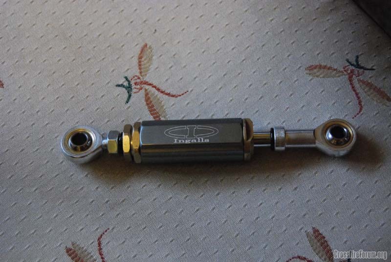

Has anyone thought about using some torque dampeners,shocks to limit some of the engine movement.I looked aorund the engine bay and thought it wouldn't be to difficult to use the front and back passanger side engine lift points as mounting spots for some.
I started a thread on torque dampers hoping one of our vendors would fabricate one for sale. As you can see, that never materialized.

Do you guys think a bracket that rigidly mounted the block to the chassis is too much? What about a couple of rods that had polyurethane bushings in each end that absorbed some of the stress? Do you think that would be too much?
Something like this, but built to scale? I would love to hear some more ideas.

I got an Ingalls dampener but havent come up with a mounting that I like yet. The SRT6 has a nice mounting point a couple of inches above and to the left of the water pump pulley with a clear shot to the frame. Am 8mm bolt fits through it nicely. Unfortunately I used this hole for a pulley on my belt wrap kit so I have to find another point.
