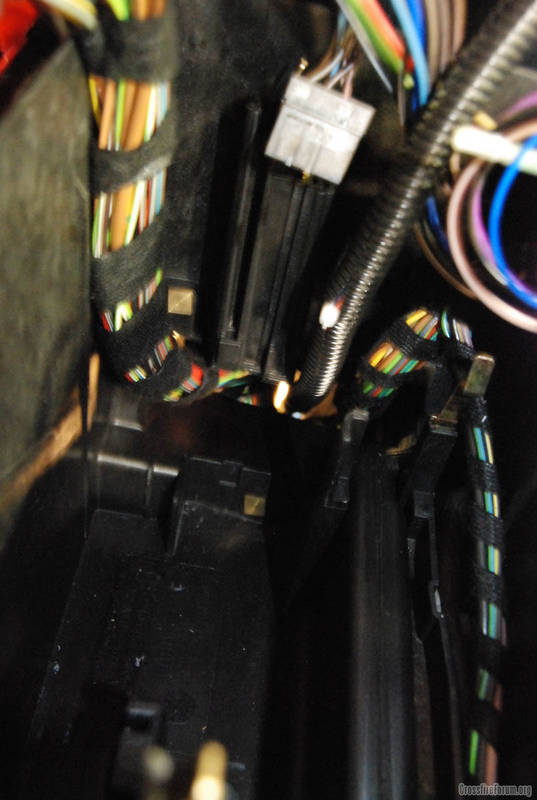

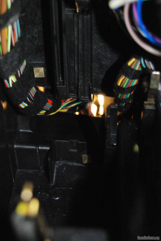

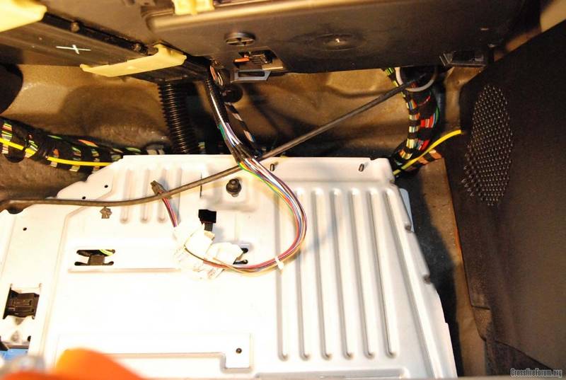

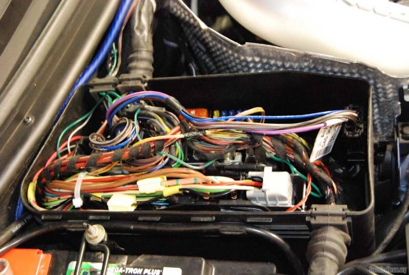

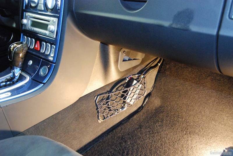

Okay, I finally got all the little things I needed to finish the cabeling and connect it to the ECU. Here are the pics of the install.
Electronics box with the RCM, ECU and BCM removed where theZeitronix cable will feed through the bottom of the box into the cabin....
Here is the cable feeding through(black cover)....
Cabel coming into the cabin behind the glove box...
Installed complete and electronics re-installed....
And finally, all buttoned up and ready to plug in the laptop....
Now it's time to go play with it...

My Zeitronix connection wire for the lap top plug in connection is hidden in the removable dash pannel you see when the passenger door is opened. The same pannel that houses the passenger air bag cut off. The two large plastic factory screws can be turned with a penny. Have you noticed the data logging when our SRT automatic's shift at WOT? You can keep the petal to the floor,but when our transmissions shift,the computer cuts the TPS way back during gear shift then to the floor again without you knowing. Maybe to keep the engine from over revving during shift,to help keep the tires from spinning so bad going into second or just for the Mercedes smooth shift?? It will also verify what Rob's has been warning us about concerning the 185 crank pulley. It will run dangerously lean at WOT. Where's our fuel upgrade Rob???? Squirrel Crusher

beautiful pictures mike, thank you! yes that seems to be the preferred way into the cabin instead of using the rubber grommet under the battery tray. do you mind if i use some of those pictures to add into our writeup?
i have our zt2 brain in the same elastic pocket there on the pass side, makes it very easy to access the port to plug in different displays.

...do you mind if i use some of those pictures to add into our writeup?
Rob, no problem at all. They are in my gallery or I can email you the files.
