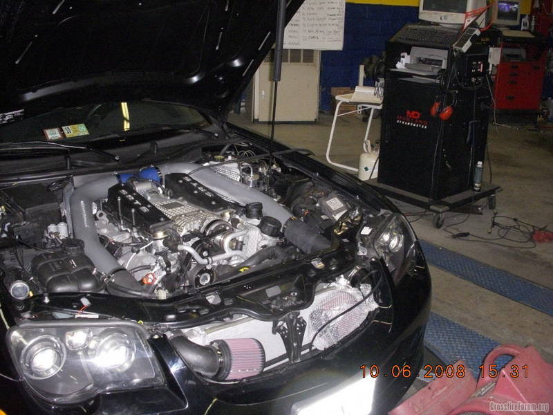

I tested on the dyno with a bag on the second inlet and then pulled it off to show the power gains it made, dramatic due to the lower restriction. Woody
Please note the bag on the before chart, charts were on same run day. First chart was my baseline.
https://www.crossfireforum.org/galle...o_data_034.jpg
This fall the faster throttle body will make its debute and well see how that does it on the dyno.

Hey Woody, Your earlier post claims 35 H.P. gain between the single and dual CAI. Your dyno's show 12.4 H.P. increase unless I'm reading it wrong. And hey; that's great, but the NW dyno charts for the single CAI show an average of 28 H.P. gain over stock. If I add your claimed 35 H.P., you would be getting 63 H.P. gain over stock w/ the dual CAI setup. That ain't happening.

I was not talking about the top, this was at the lower end around 2500 as I remember. Autocrossing needs to get off the corner like driving on the street and this gave me a great gain at the lower end. I could not find the two dyno results that I superimposed to show the delta.
Yes there is some gain in the big end but that was a plus overall. Please see the gallary for more photos showing the results. I also have some charts from the Carlisle 2009 dyno jet runs showing the fuel air mixture tracking over the power band.

I think he is looking at power under the curve, not peak. Look at the diff. between the "bag" and the dual at 2K rpm and 2.5K rpm. big difference there and a bit of an increase thru the entire rev range above 2.5K between the 2 also.
I am sure he will chime in, but that is what I have always understood him to mean.....power under the curve, not just peak.
