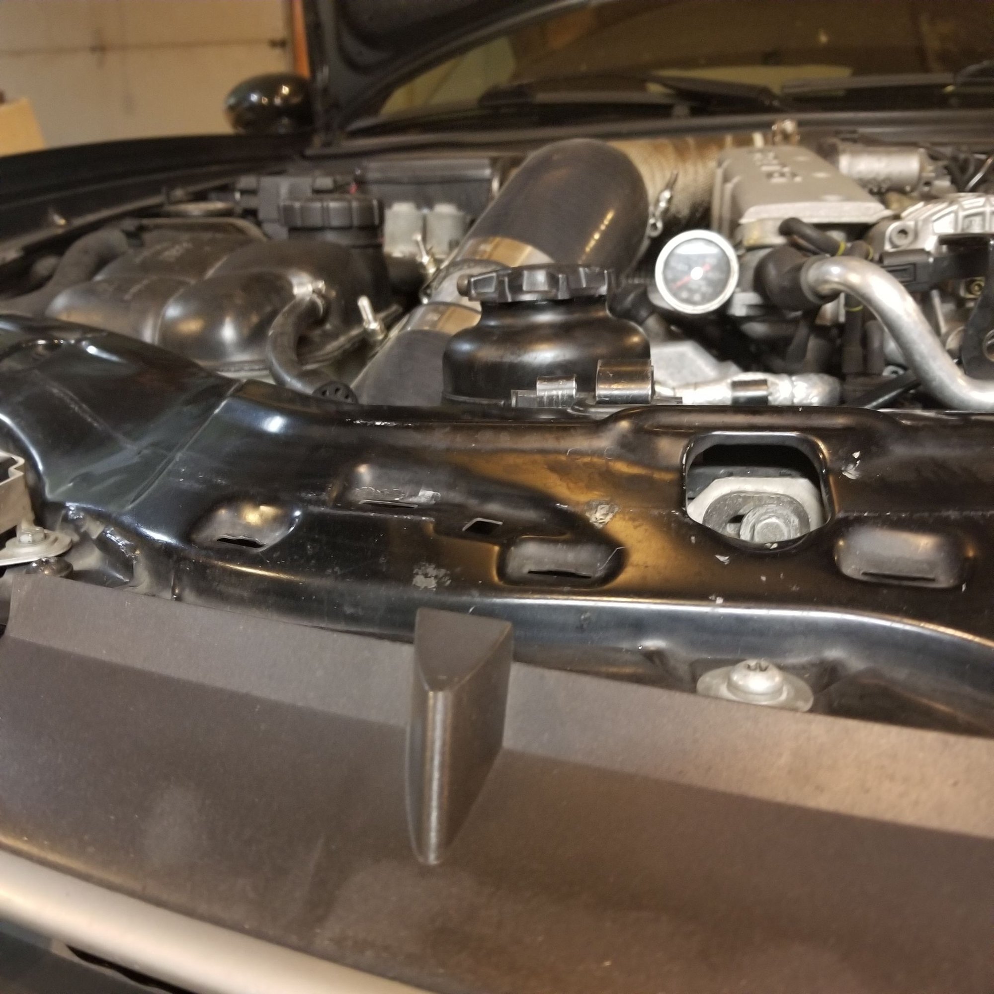

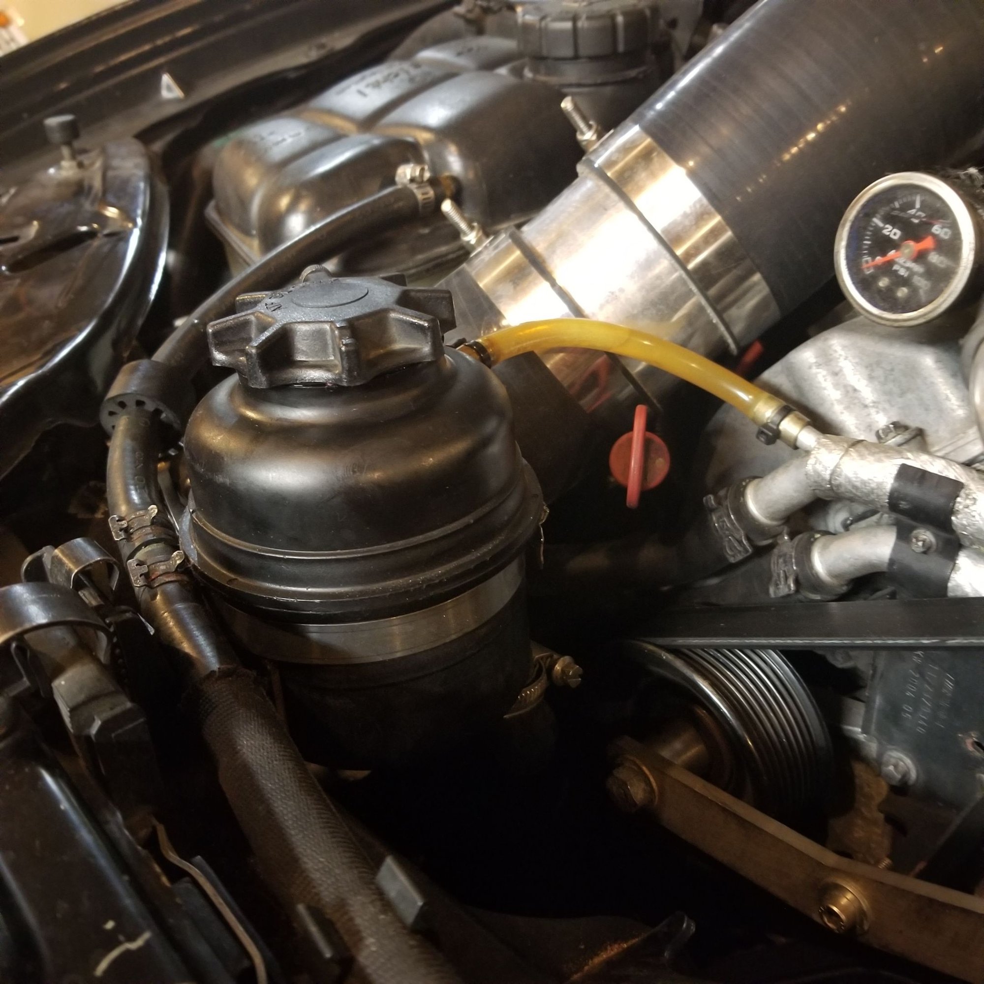

I did the same BMW IC separation tank others have done and I also have the "always run IC Pump mod" but looking in the BMW tank there is every little coolant coming out of the small fitting near the top of the BMW tank. Should there be a steady flow coming out the small top fitting ? Car runs great so I know I don't have a bad IC pump. Any ideas ??

As tunaglove suggested(I think), it may be an air lock. Also, the BMW reservoir cap has a vent hole in it; so the vent hole should be above the high flow level of the IC system line. It's hard to tell from the pictures, but it looks like perhaps it is placed lower than the feed line? No evidence of weepage there?

Yep, it was air bound, I clamped the top intercooler hose and started getting a nice steady stream coming out. Got all the air out and unclamped it and still got a good stream of coolant flowing. All looks good !!!

Looking at your photo, I think you should try to get the tank as high as possible. It can go quite a ways before touching the hood.

Yes, you shouldn't be able to see the flow cascading out the top nipple. The flow should be under the fill level. You can check flow with your pinkie finger. Even after a good run at the track, my IC water temp. is never too hot to dip the pinkie in. It's nice to be able to monitor the fill with the reservoir. I anticipate that some day perhaps, I'll see it low and may have to buy one of Rudy's custom IC's.

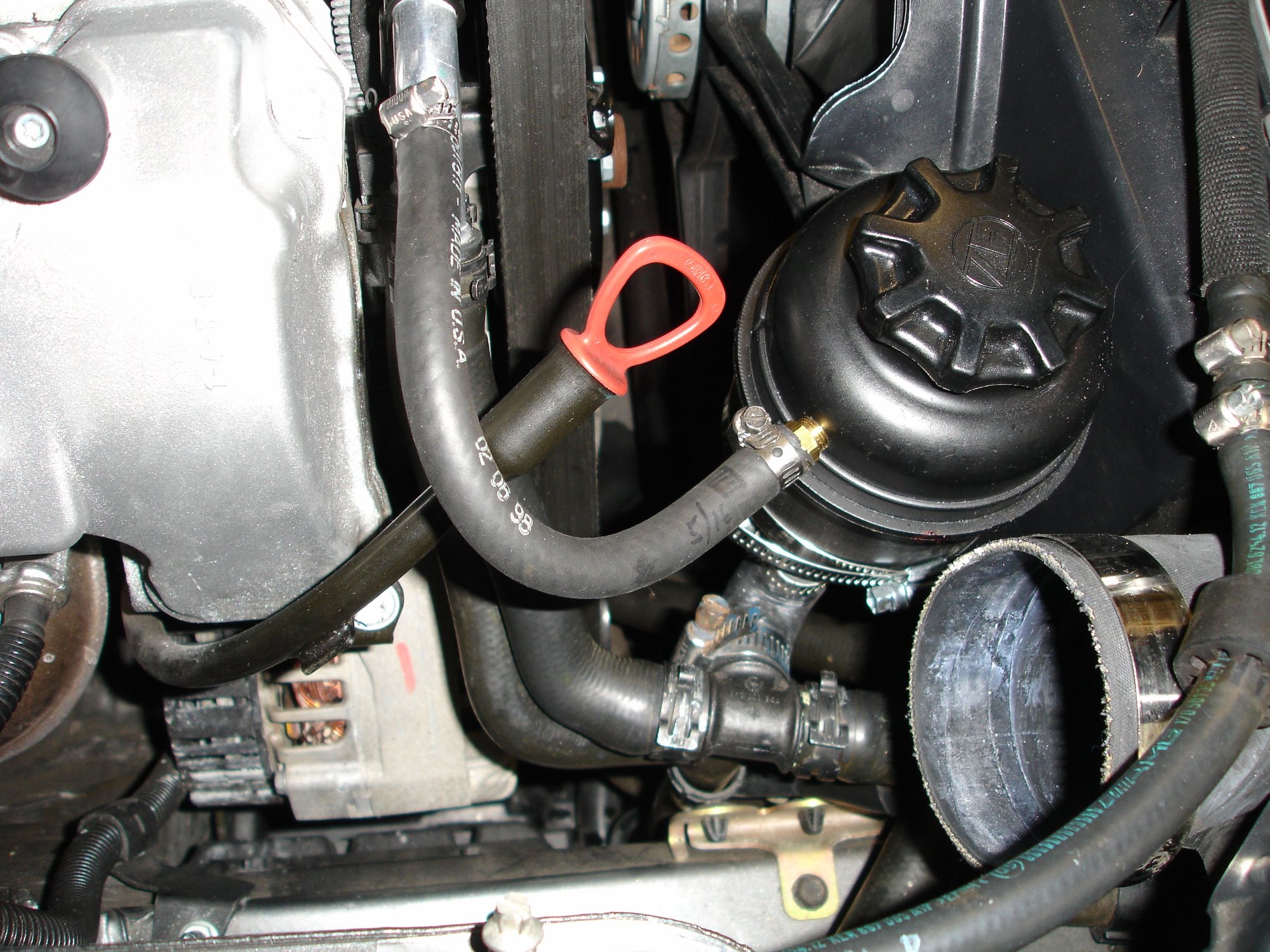

How did u run the bottom hoses of bmw power steering bottle? Or is it just used to fill
Old Sep 1, 2018 | 06:57 PM
tunaglove's Avatar
Posts: 1,413
From: White Bear, MN
Default Re: Intercooler Separation Tank Question
Just use one bottom port to a tee. Plug the other.
