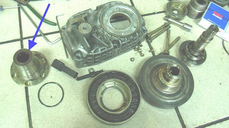

Old Mar 29, 2019 | 03:59 PM
EdwardB's Avatar
Joined: Feb 2018
Posts: 31
From: Arizona
Default Re: Super charger issues.
Old Mar 29, 2019 | 04:31 PM
Likes: 648
OK, where is the excess play or insufficient play?
Old Mar 29, 2019 | 04:43 PM
EdwardB's Avatar
Joined: Feb 2018
Posts: 31
From: Arizona
" Clutch Hub that's mounted on Supercharger is Warped 0.05 - 0.010 and The Play between Bearing and Shaft." Per my mechanic

Okay, after another visit to my mechanic and a phone call from Jim and he helped clear some things up.
The shaft itself is most definitely worn, most likely from heat transfer. The pulley slides in and out of the shaft with NO resistance. I have this all recorded and will be uploading to youtube and be posting on here to show you guys.
We are going to JB Weld the shaft and make a better fit for the pulley, and have ordered a separate blower and plan on rebuilding it after we get the prices worked out from some stores to have a new one laying around when and if this super charger fails.
Thanks for your guys help, this has been a long two weeks.
I am still in need of shims and will be contacting eurocharged again to see if they have them..
If anyone can help me find some, I'd greatly appreciate it.
