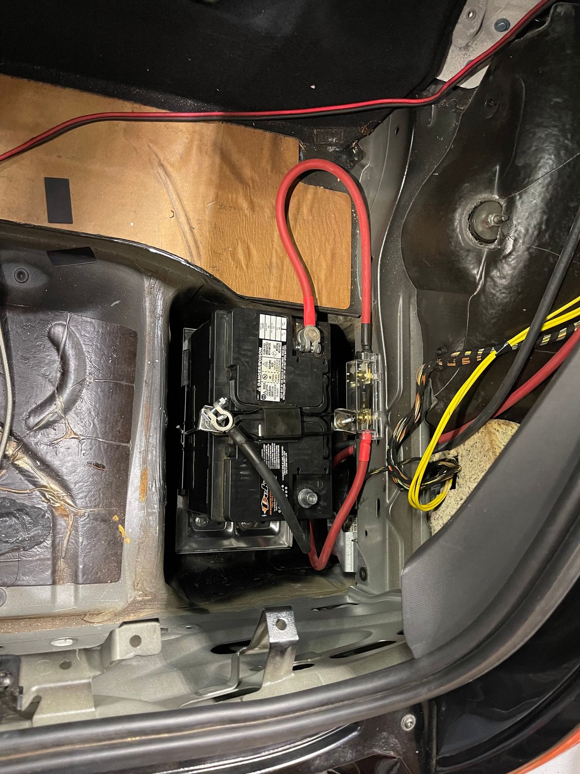

progress.
Battery relocated to passenger side trunk.

Is the battery vented outside of the trunk?

Originally Posted by stryfox
progress.
NICE cubbyhole for the battery! Just one suggestion? With that metal tie-down so close to the POS junction post, maybe it would be possible to turn the battery around so the POS cable is towards to center of the car (more room in case of the tie-down movement, being as the junction box POS post is so close to the tie-down). Yes, I can see the plastic cover on the junction box however I do not know how much or where that tie-down is secured and if a vibration could move/shatter that plastic cover.

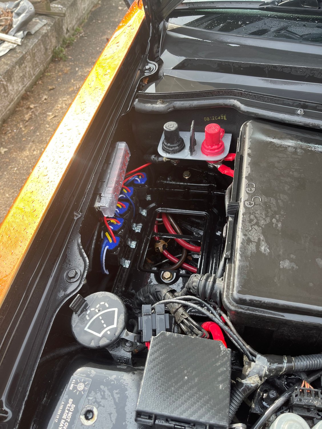

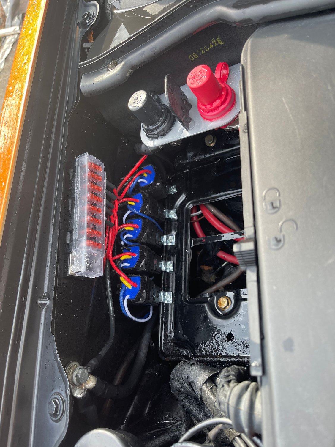

Old battery location, jump start lugs/fuse box and relays all ready my to mount nitrous, fuel and purge solenoids when they arrive.
going to rewire hid headlamps to new relays at fuse box too. That’s next.
no. I ordered an optima sealed dry battery it did not come yet but I need to get to work on Monday.

Default Re: SRT6 Nitrous revisited looking for experienced opinions
i have an optima battery on the way. I’ll verify the mount is good when I put that in. 👍

Nicely done there. Was it a pain to route the new battery cables from the rear to the front; seat removal,drillling,etc.? Lumps in the carpet? What size cables did you use?

Which Optima battery did you go with? I have thought about relocating my battery to the same place, to free up room for a water tank for a Killer Chiller.
I’ll double check as I had the office parts guy order it for me. I believe an h6 size yellow top.
we stock dekka batteries but I want one I don’t need to bother venting.
I ran the cables up the passenger side. No holes had to be drilled. Did not take out passenger seat. Removed sill plate, kick panel and under dash cover.
there is a rubber grommet under the battery tray by the factory amplifier location that you can run them through. I used 1gauge. 300 amp fuse at new battery.

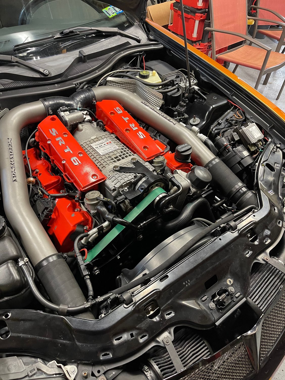

installed the Needswings pulley saver kit and a scatter shield today.

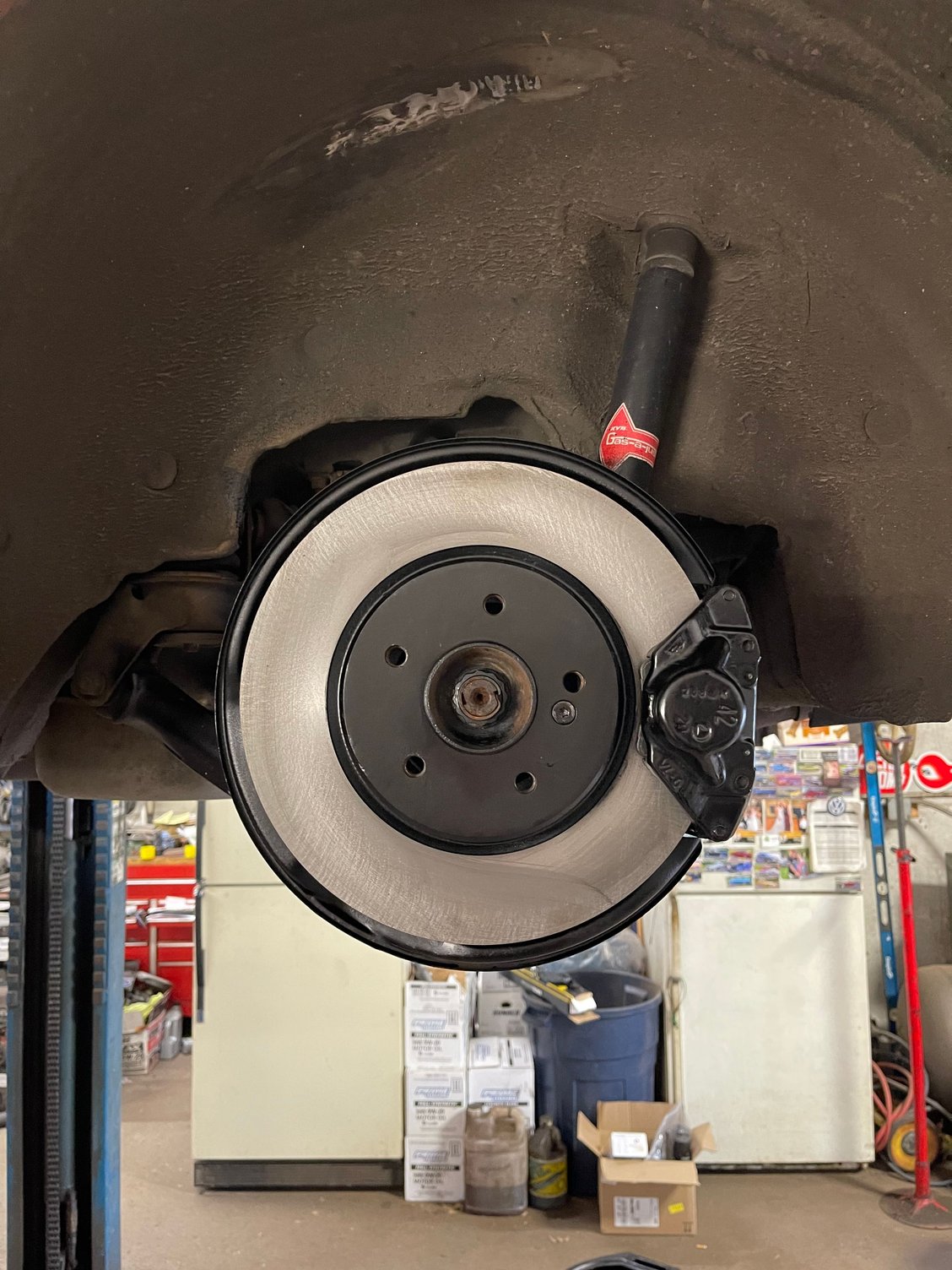

got front and rear brakes done. Cut rotors and stainless steel brake hoses.
power stop z-23
stop tech hoses
installed sl55 fuel pump that took 10 minutes tops.

Just a quick question? Is that shock having something rubbing along the outside of it (wheel side)? Am curious...
