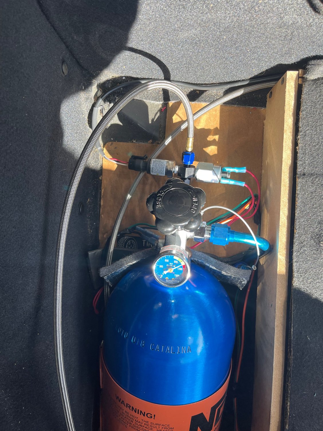

Cleaned up relay wiring and off to do some more “phone recording” data logging.
once the afr ratio is done being dialed in I’ll retune the meth then off to the dyno for nitrous tuning.
getting closer.

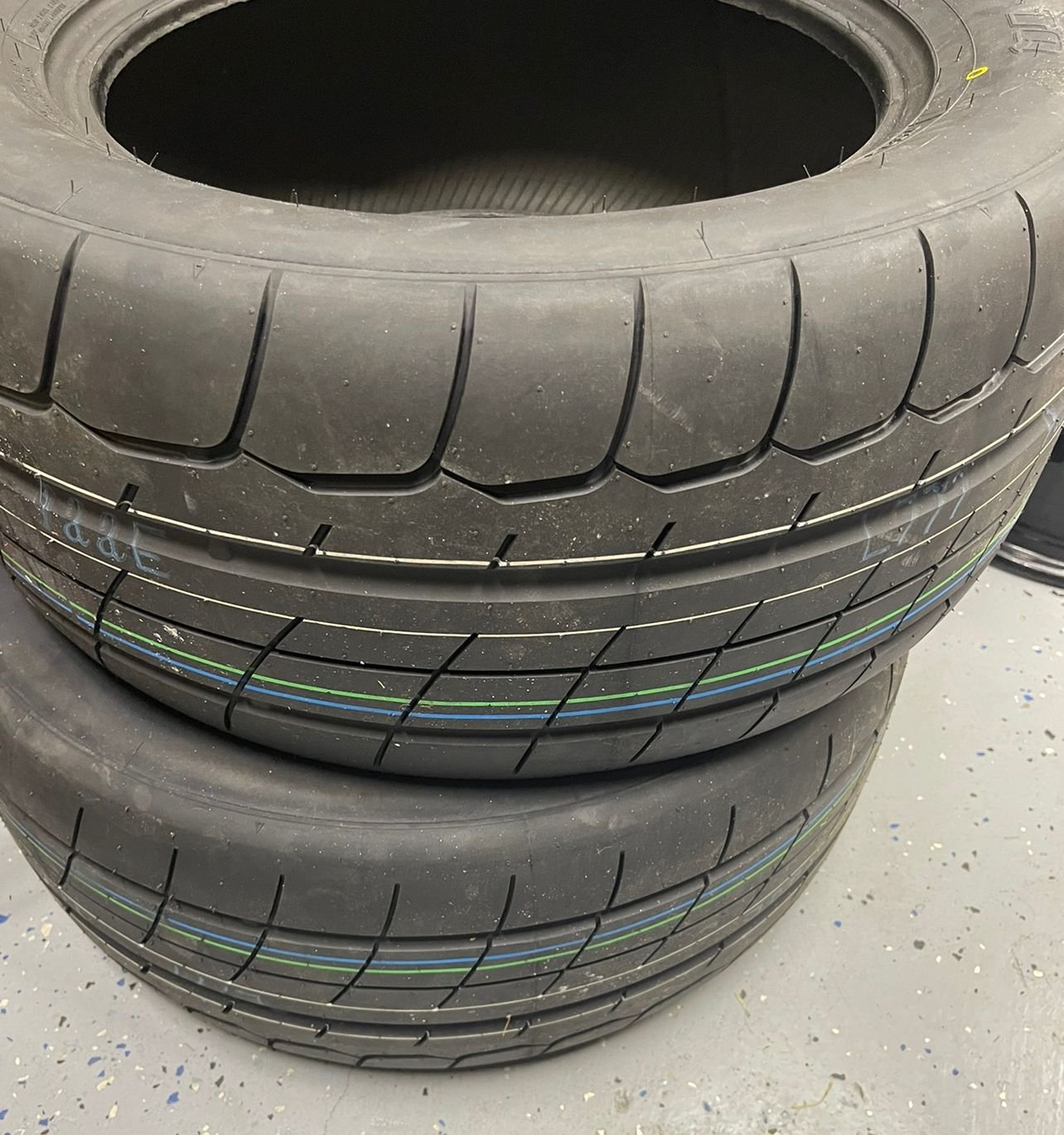

New sticky tires have arrived.
I went with Toyo proxys tq as I was able to get them local and on special. M/T are back ordered everywhere. For a drag rim I have something different planed. Got the idea form someone else doing fast srt stuff.

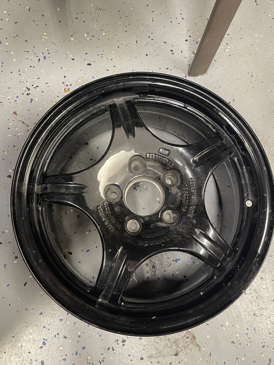

MB spares. Going to remove the raised print that is molded in them and refinish them.
they are light!

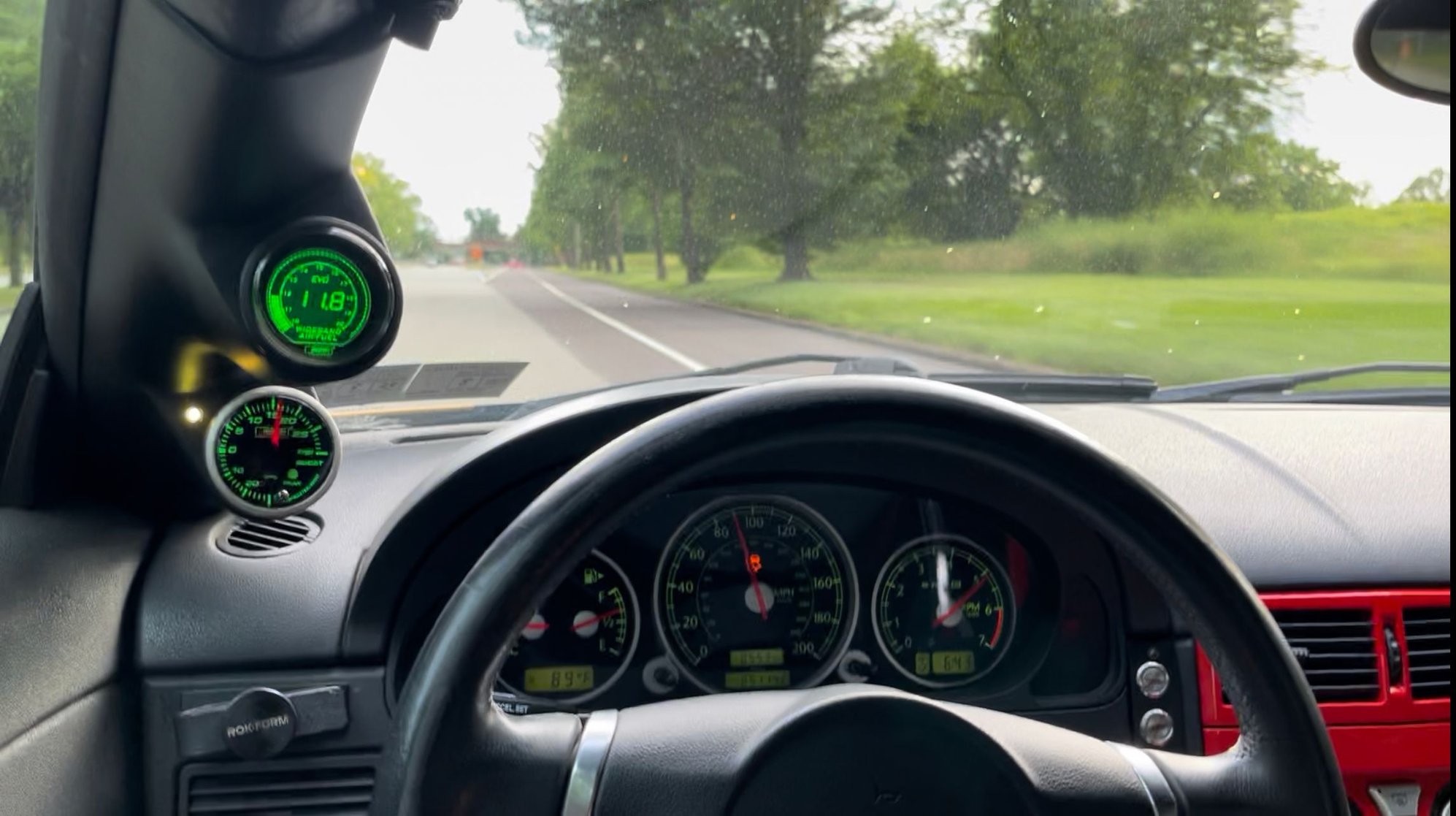

Update. Did a couple test runs on the street.
12.4 according to dragy. Only a 2.0 60’ I need to work on that. Use to hit 1.7-1.8 consistently. That will bring it down considerably.
before this round of mods I ran 11.9 once and usually 12.0-12.2 at the track so we are getting close.
the 12.4 is on the street with a nitrous tune that has less timing (no nitrous spraying). I think with a good launch I could pull a 12.2 or better as it sits.
Im getting it dialed in but even with the tweaked intakes, fuel upgrades, injectors and tune from this round of mods I’m not sure if that will compensate enough with the new nitrous tune with less timing to hit my old times.
I don’t want to keep switching tunes. I want to run the nitrous tune all the time so it’s just ready to go.
I am seeing 10.9 afr for a second then it climbs to 12.2
ill get this sorted then we shall she what she runs on nitrous.
I have done some test hits to get it all working and spraying afr close. It pulls hard.

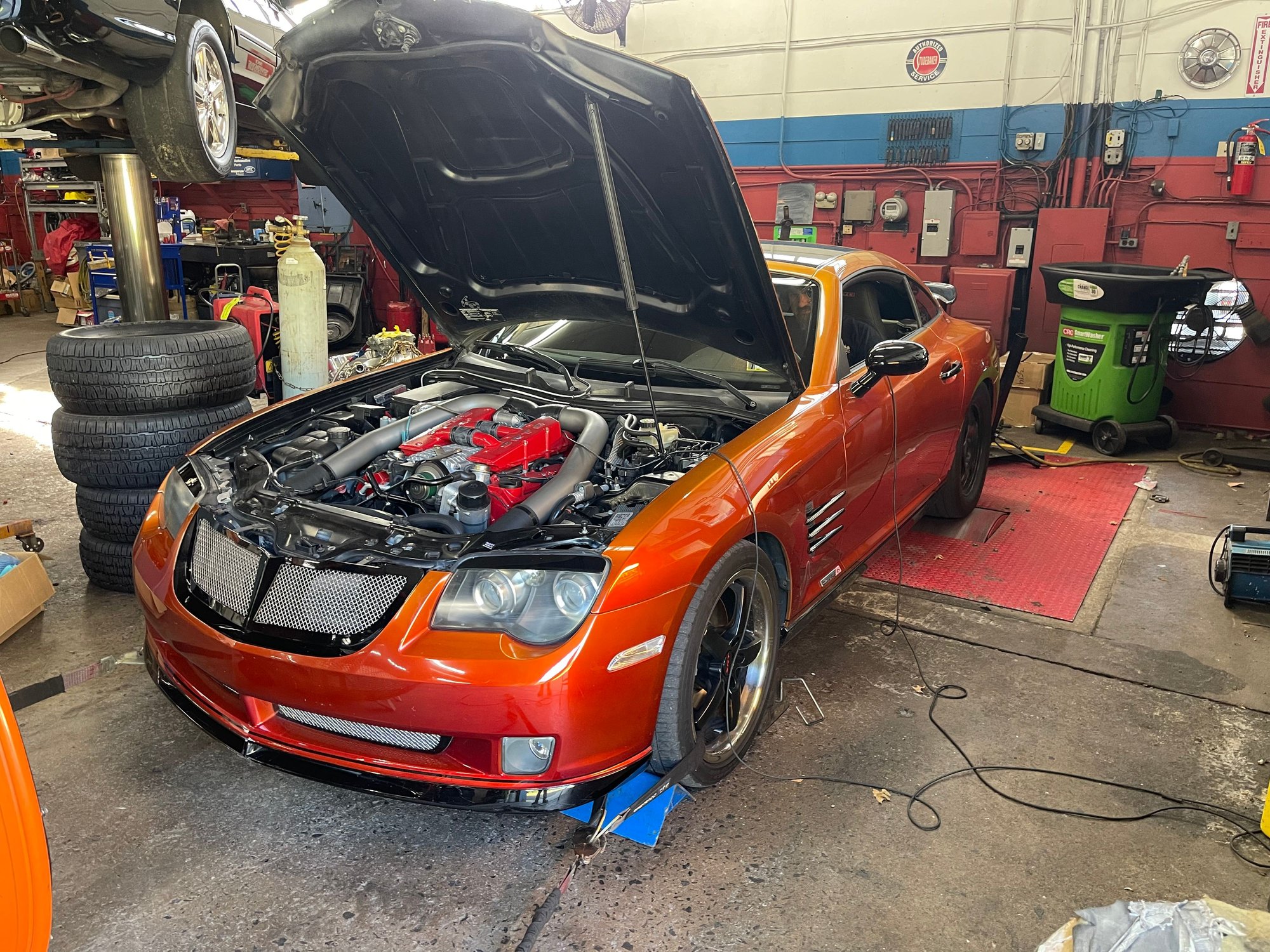

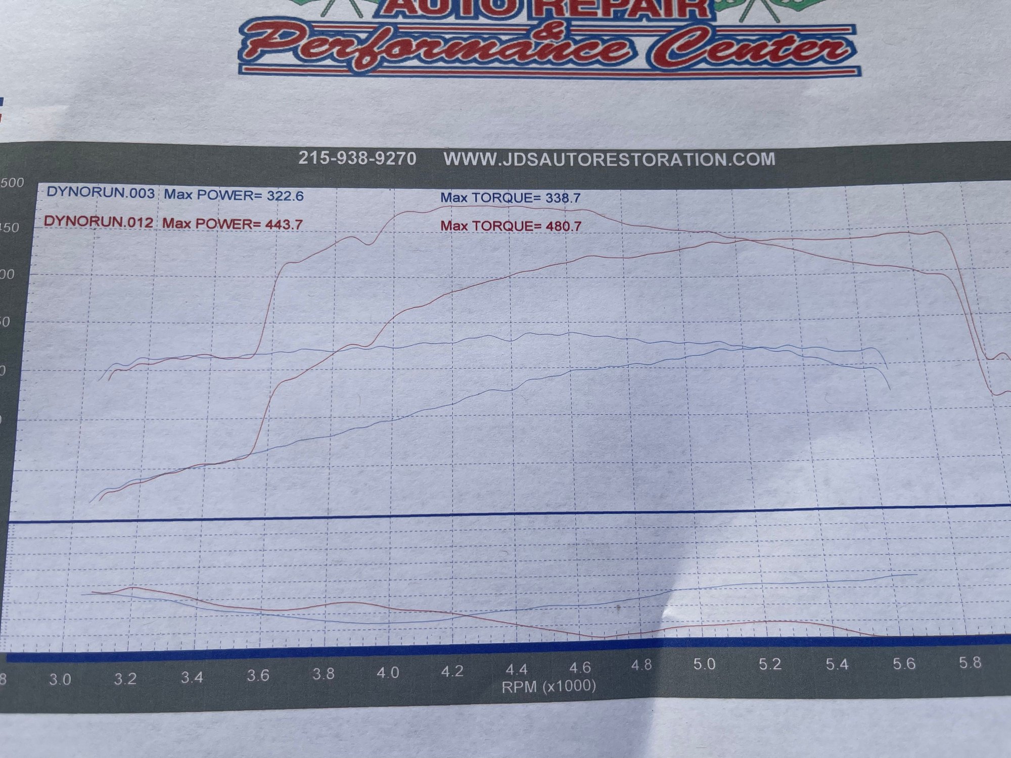

It finally happened. Got time to dyno it and finish jetting and setting up the meth and nitrous.
443 hp and 480tq
car makes good power with my mods when not spraying even with my vtech tune that has timing removed for the nitrous.

Default Re: SRT6 Nitrous revisited looking for experienced opinions

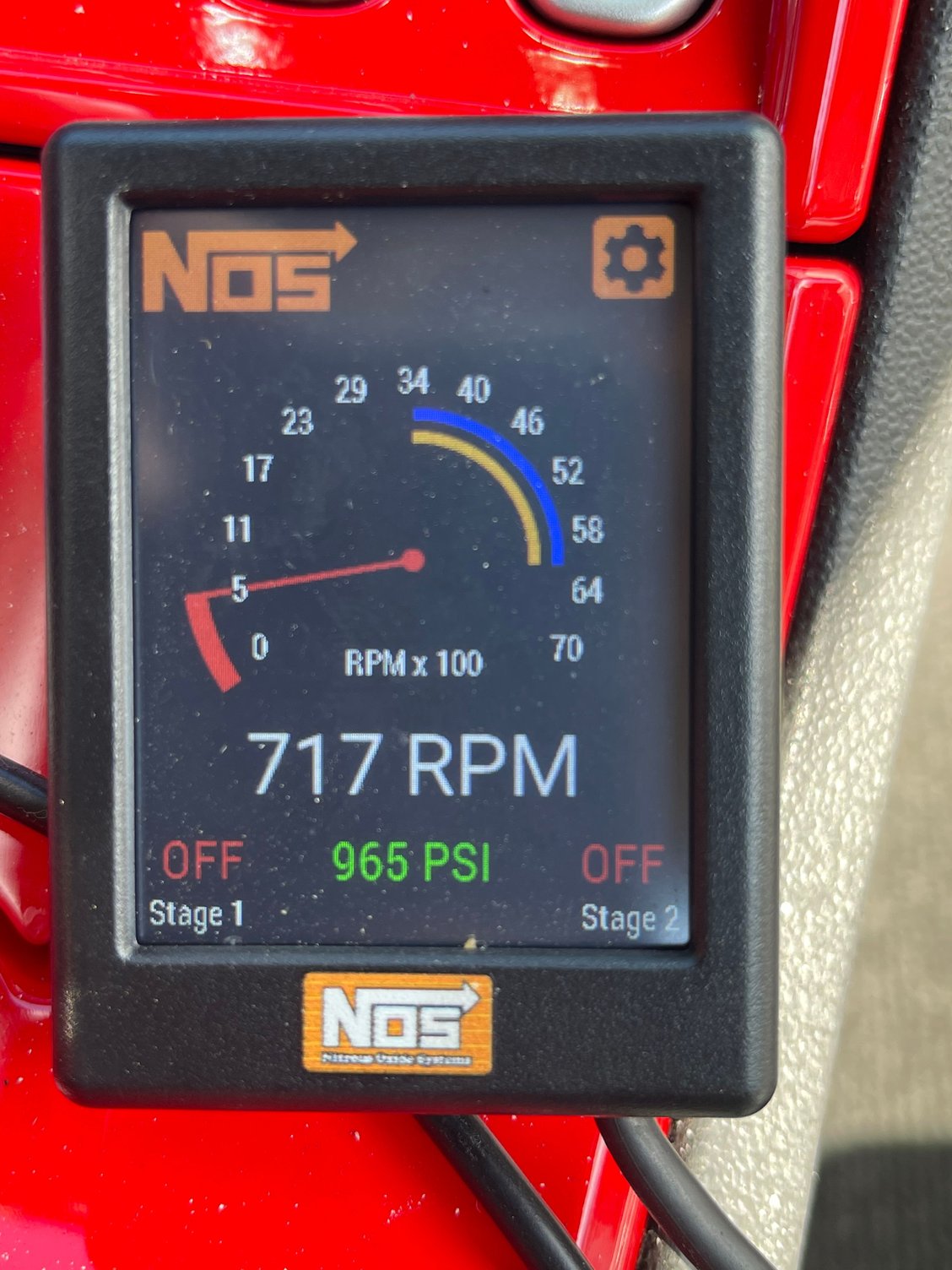

I was having trouble regulating bottle pressure consistently with a thermostat controlling the relay. Upgraded to a pressure switch and was able to dial that in better. I also add a transducer so I can monitor the pressure from the mini controller screen.
worth the extra bucks.
