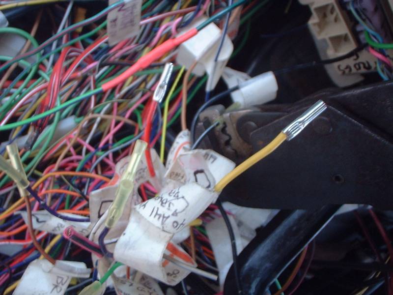

I added backin a pcm wire that i thought was abs last sept. It supplies 8 volts to my cam and crank sensors. oops! and the comm twisted pair got cut going to the dash, so it's reconnected at the engine again. I needed to lengthen them anyway, and the abs wires to the rear of the sedan were the only ones long enough to reach to the dash-
so I am reusing them.
and the dash tail is still losing weight- power window and steering and seats, belts, park lamps, courtesy lamps. stuff I am leaving connectable tails for with labels if I need them later. the turn signal ind lamps in the instrument were a double take as I will need them, but will use the vw t/s wires and the chr switch.
so i finally got the dash and the detroit harness together- a beginning. the wound up dark wires on the left foreground are the fuel pump leads.they will need to be shortened.

I actually started designing the hybrid circuits today--chrysler ign sw feeding ign-on power to rail 15 in the vw fuse box and such- theres a few circuits/items that need integrating-- chrysler sw with vw wiper motor--chr headlight sw with vw headlights--decided to not use the speed proportional steering valve on this system- I would possibly have to install the chry steer rack too, which shoots me in the ***, so forget it. turn signals use chry switches and relays with vw ext lights.
I draw out the systems from each book first, condensing them to one sheet with all the wire sizes and values. studying one for a while, until i understand how the juice flows and why. then finding equivalent wires in each system i can splice where needed. the horn system is designed. the hazard/ turn signal system is coming along.

the last two weeks were spent designing hybrids on paper. now that I have a roadmap, the splicing can finally move forward. this is the L headlight well where the wire harness penetrations are.
and the stereo amp in the eagle was in the trunk, so i used the tail for that to stert connecting the dash to the er.

4 wire fuel tail is in with chrysler grommet
the big gray body plug elimination tail gets connected to the wires from the back
