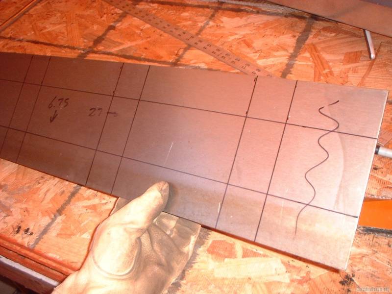

what is it?

46" wide, 8 panels. I was going to work in visors too, but top tint may negate the need. I paint it next and set the mirrors with rtv. I may draw a string down it's length and align the glass first. some of the panels are off a little and get me cross-eyed looking at them.
this was something I have wanted to build for over 20 years. it uses the oe visor mount pads instead of drilling new holes.
