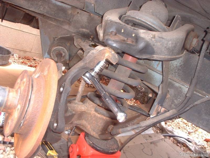

I removed the entire front suspension today. the bolts are all clean and repainted. I'll need 2 upper ball joints. the upper A arms are stiff on their bushings, so I will have to remove those and replace the bushings, which i already have from the last van. the lower control arms had heavy rust on them, so i will get them sand blasted and paint them next week. I guess everything will be closed until tuesday. happy memorial day
this is what it looked like last month
and then

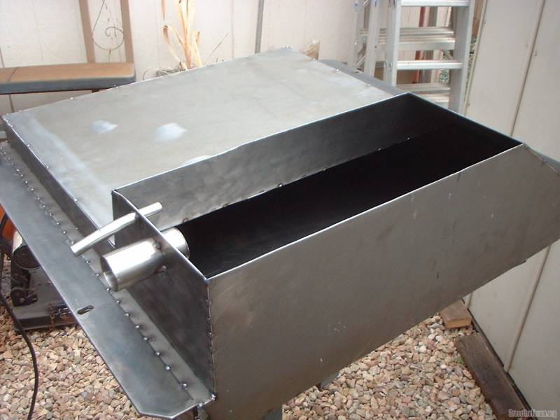

the tank is ready to tig weld now--wow! I got the top cut, fitted and tacked all today. 5 pieces in all, and the drain and vent too. I switched the filler tube for a longer one
and this is the first tank I have ever made too. It was fun.

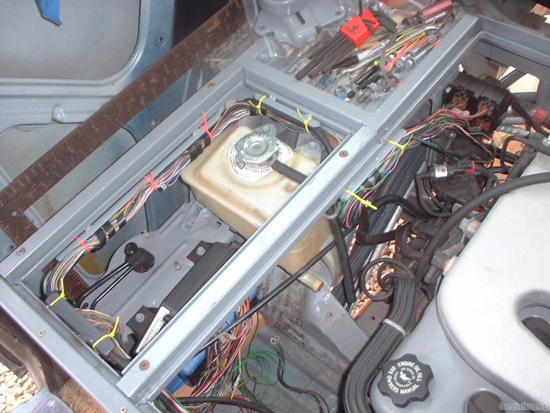

back in june 2010 I installed a 94 eagle vision 3.5 v6 and 42le trans under the back seat of my 1989 vw vanagon. I had just finished a 2.2 4 cyl subaru conversion hanging on the vanagon transaxle. I didnt like that it wasnt a torque motor, and after talking with my smog ref in fullerton, california, I realized that the only way to get a v6 in a vanagon was with a factory matched transaxle. I had lost hope after considering most brands out there, which all failed my requirements due to dimensions or too small or just too expensive, until i walked up on a 94 new yorker in a jy and had an epipheny. an honest to god longitudinal front wheel drive powertrain under a low hoodline with a compact transaxle that had a good rep [unlike t&c vans] that was over 3 liters. and it looks cool to boot.
I bought the donor car from an air force reservist who took great care of it and sold it to me with a full tank-- the fact that i couldnt burn it all going to san diego and back was a good indicator of mileage too.
so- this sits under the back seat and is completely hidden. there is no loss of floor area forward of the bed seat.
