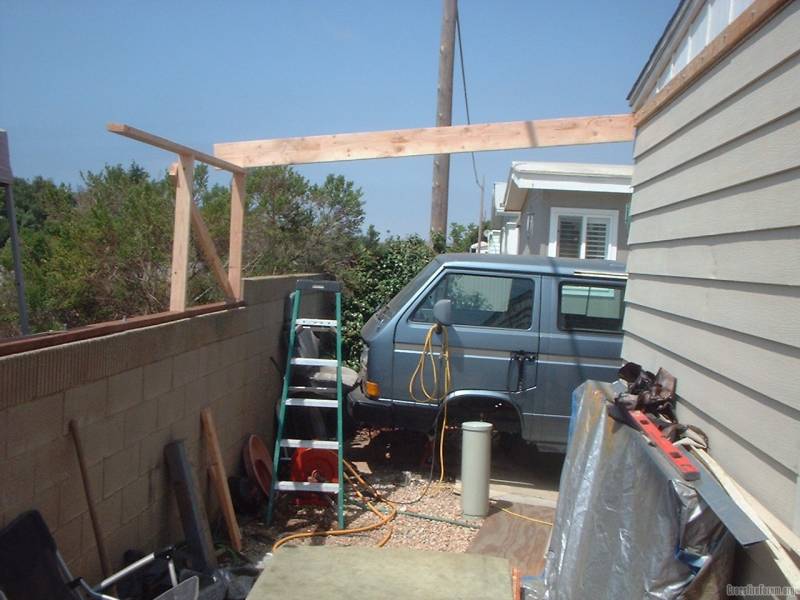

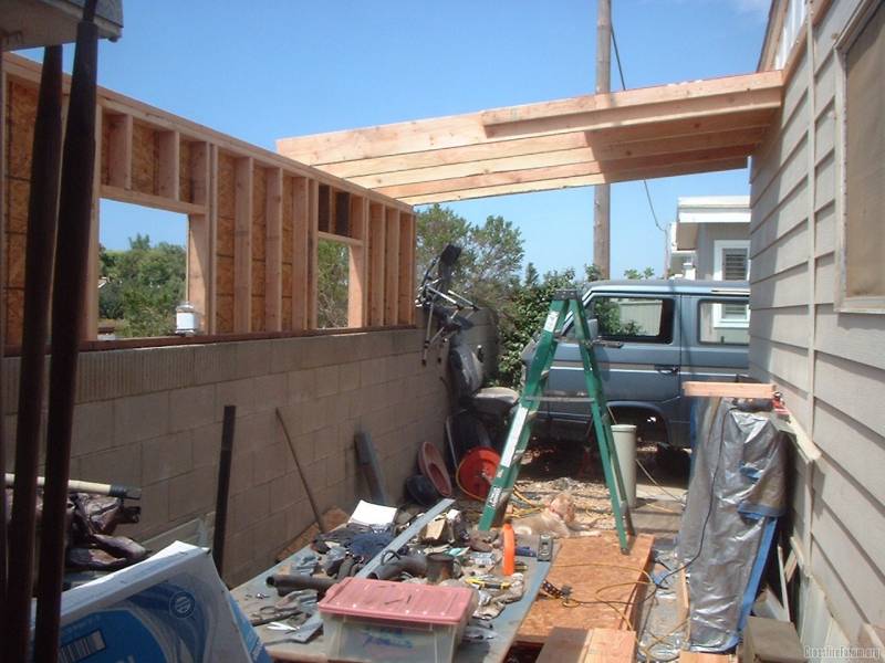

then, I had momentum and started on the shed roof over my work area. I will be able to rebuild things and sew again, out of the rain.

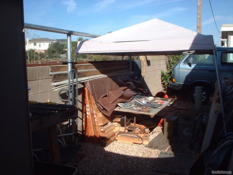

the park didnt like my shedroof--so i had to take it down-- and a galvanized pipe frame will support a canvas cover I can take down at will.
