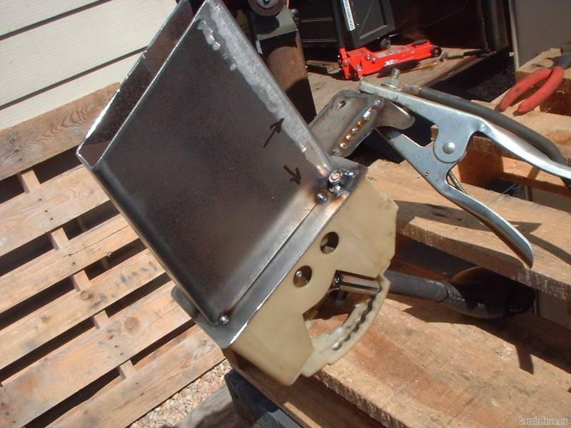

I sorted out the ebrake and shifter cables for the most part today. this is a shifter cable bracket I made out of a mopar trans part and a simpson strong tie construction bracket i have had laying around for years.
