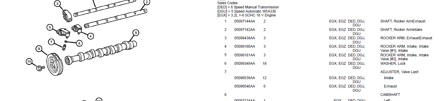

A little clarification here. First, the thread is 6 years old. Two, the talk of lifters and tappets does not apply here. This engine has needle bearing rockers that ride directly on the overhead cams, no lifters, no tappets, it has a finish like a fine swiss watch. What they may be taking as tappet noise is probably the clearance between the rockers and cams.

No, I don't think there are any. The rocker roller end rides on the cam, the other end contacts the valve stem. Somebody correct me if I'm wrong.
Yes Jeff, there IS a Santa Claus, check out part #7 below .......

[left][QUOTE=JEFASOLD;915724]
I thought I tactfully did correct you.
Swiss watch or not manufacturing tolerances and expansion due to heat cannot be avoided.
