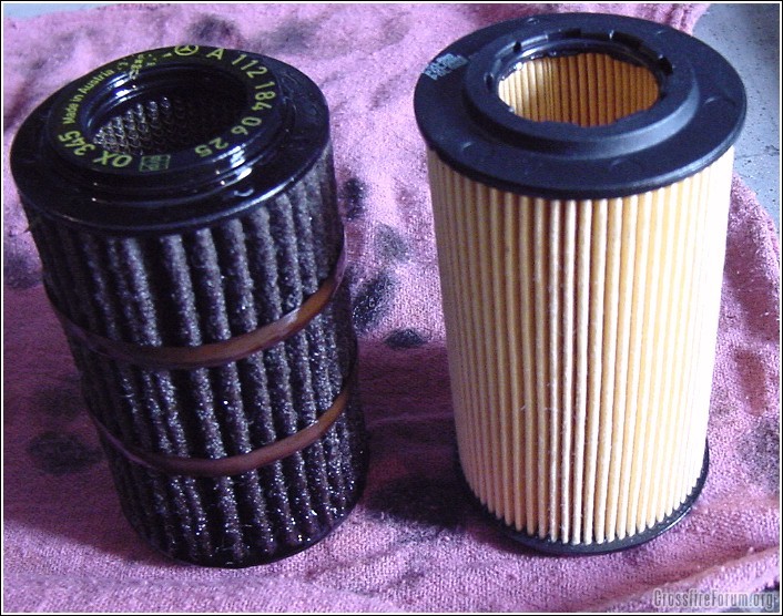

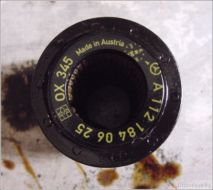

Recently purhasing my '04 Coupe with no written history report from the owner, I figured it was time for the oil change. I have used NAPA oil and filters in our fleet cars for years with no problems. With that in mind, I purchased a NAPA oil filter. After some comparisions, I am not sure that was a good idea.
Can anyone tell if this is the original oil filter?

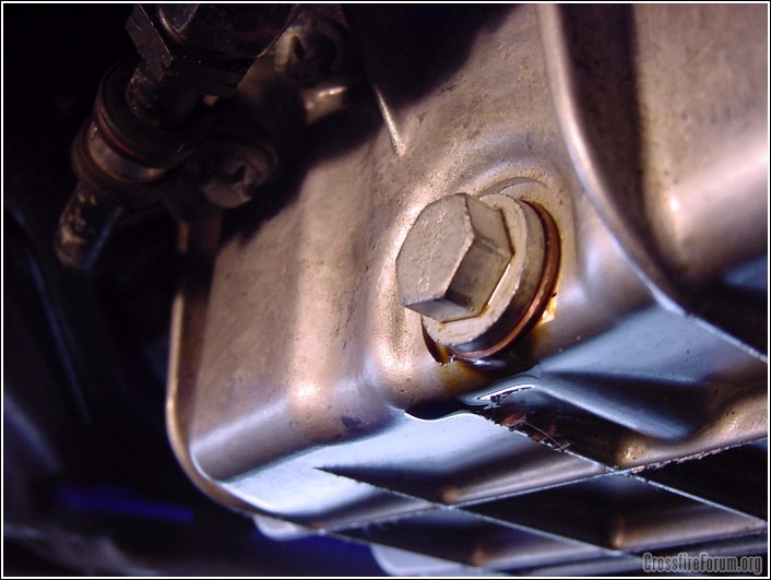

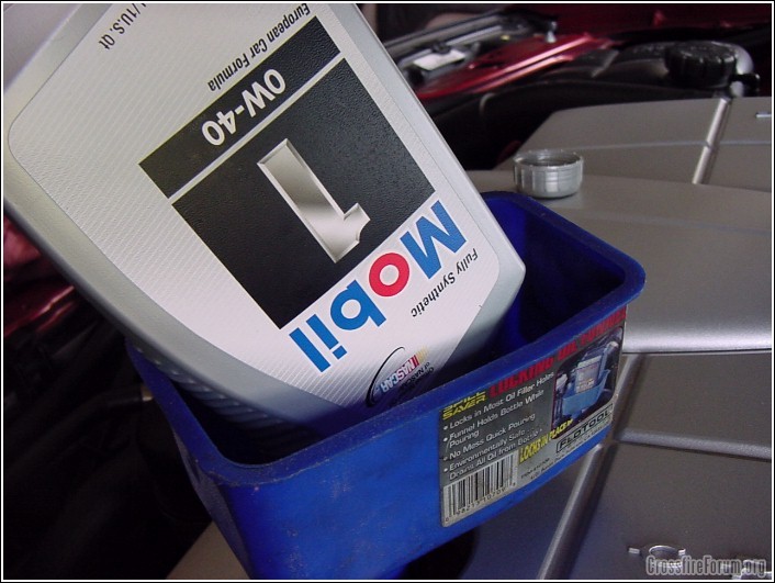

Once I got the belly pan off, the plug was very easy to get to.
I happened to have the perfect fit wrench in my toolbox for the filter housing.
I added 8 qts of oil.
Did you notice you can't get a funnel down in the fill tube real good. That is a PIA to hold the funnel the whole time.

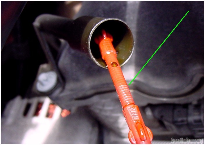

Is this the proper level after adding 8 qts of oil?

Also 8 quarts will bring your oil level to almost full on the dipstick.
The photo shown is a fine oil level.
Since it was made in August of 2006, I doubt it is the original filter.
FWIW - Your new filter is a paper filter, not a fleece filter. It actually will do a great job filtering your oil, but it isn't up to the task of lasting a full 7,000 miles for a standard FSS oil change interval. For that you'll need to get a fleece filter.
ALSO, as far as the funnel, I've got a tip that can save you some time and effort. After removing the old oil and oil filter, simply pour the oil down the filter opening. It is a nice big target, and Mobil 1 bottle balance well on it to allows the bottle to drip out for a few second while you open the next bottle.

Like your idea of pouring the oil into the canister. That's good for 8 quarts, but topping it off requires the old-fashioned way. Has anyone found a screw-on extension that fits a Mobil 1 bottle? Why couldn't they manufacture a container with the same size cap as the other oil manufacturers? What a PITA!

ha ha ha that paper filter looks like junk....go with fleece
