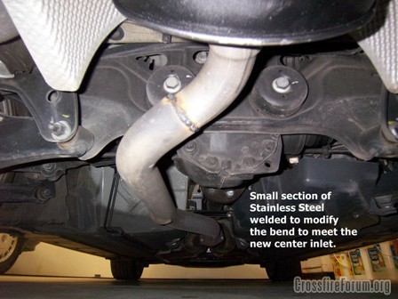

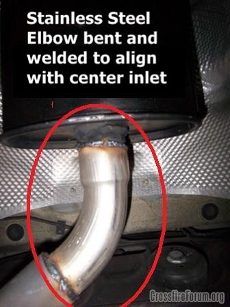

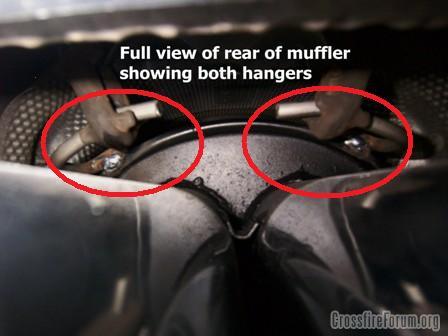

Ansa Hi Performance muffler installed today.
Part # UN0827
Youtube links with sound clips (headphones advised)
http://www.youtube.com/watch?v=-bnNGO065xM
http://www.youtube.com/watch?v=0a80cFM3XXA
Click the thumbnails below to see the OEM after removal.
See where the pipe was cut and use this for reference.

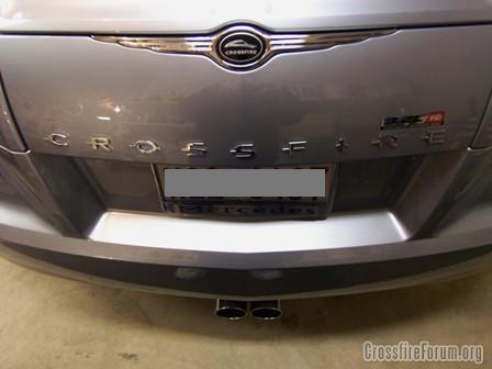

Gary, that sounds good and looks like a great install. I need to ride in it at the Dragon because I am definately going with some kind of exhaust mod this summer. Does it appear the tips are too close together to fill the opening or is it alright?

Gary, that sounds good and looks like a great install. I need to ride in it at the Dragon because I am definitely going with some kind of exhaust mod this summer. Does it appear the tips are too close together to fill the opening or is it alright?
Nice job, James
The tips are close together as all the round tip performance mufflers are.
It does not fill the entire area as the OEM tips did but it still looks very nice IMO and is perfectly centered
This particular muffler does not allow a way for the OEM tips to be welded on either.
