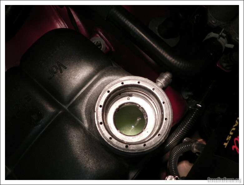

I did a coolant flush on my 04 crossfire (100,000 miles) about a month ago. Drained it, then put the flush addative in it, ran it then drained that then put all distilled water in it ran it again for 10 mins drained it yet again, then put the 50/50 mix of Valvoline G05 coolant and distilled water in it. Well today I open the hood and im checking everything under the hood and I look at my overflow tank and the coolant looks really dirty.......I cant remember the exact color the coolant is (G05) Does this look like really dirty coolant water to anyone else of is it just me????? ....I might just flush it again.....photo.JPG

I think the normal color of Valvolene G05 (HOAT) is yellow.
The long life version (5/150) is orange.

It is very hard to get a good pic at night in the garage. I changed mine out about a month ago but I used full strength, and refuse to use any kind of cleaner in my systems. I suspect you didn't totally rinse all the cleaner out and now you have contaminated your fresh coolant. Unless you drained the engine block, you did not totally drain the entire system thru the bottom of the radiator. With a flashlight I can see all the way to the bottom of my reservoir perfectly clear.

Great reference pic james its to dark to get a good pic of mine but it does NOT look like that .... sigh it looks like pickle juice and choclate milk had a fight............
