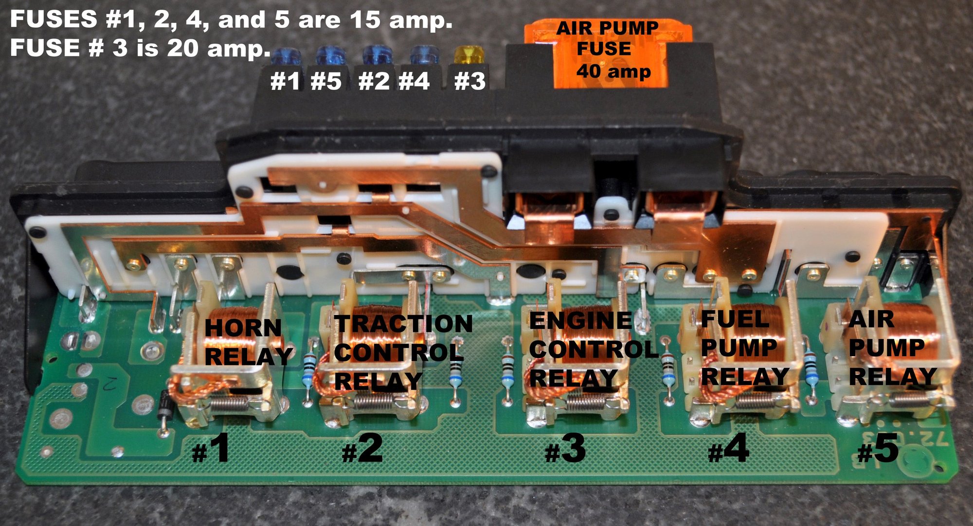

Could be the relay control module ? I believe there is a relay in it that activates the fuel pump.You say you re-soldered the ECM, do you mean the RCM? Don't forget to check the the relay contact surfaces on the RCM

Here is the fuel pump relay in the RCM :

How long has it been "cranks but does not start" ? Did it run while you had it ?
What you do next depends on your skill level but anything is fixable.
First thing is to download the '05 service manual (.pdf in Archives) and read up on what to check when it does not start.
That said if mine I would remove the engine cove & introduce about 1/2 oz of hi-test into the intake (do not pour on MAF sensor. Then replace the cover. Crank it and see if it even sputters. NOTE: usual caveats about professionals only apply.
ps if sputters usual culprits are fuse 5 or the fuel pump relay both on the RCM) or a bad solder joint on the RCM. ($128 on Amazon)

Listen for the fuel pump to run for about 2 seconds when you turn the key to the ON position.
If you don't hear a buzz sound from behind the seats (gas tank) then the fuel pump is not getting juice (Voltage).
Could be the fuse on the RCM but my guess is the fuel relay in the RCM is bad. I can replace that for you.
If you want you can open the RCM and force the fuel pump relay contacts closed then try to start. If it starts you found the problem. I can fix that for you!
If you DO hear the fuel pump, disregard all of the above. :-)
