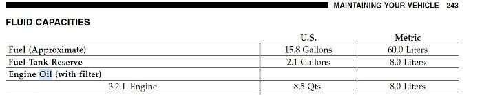

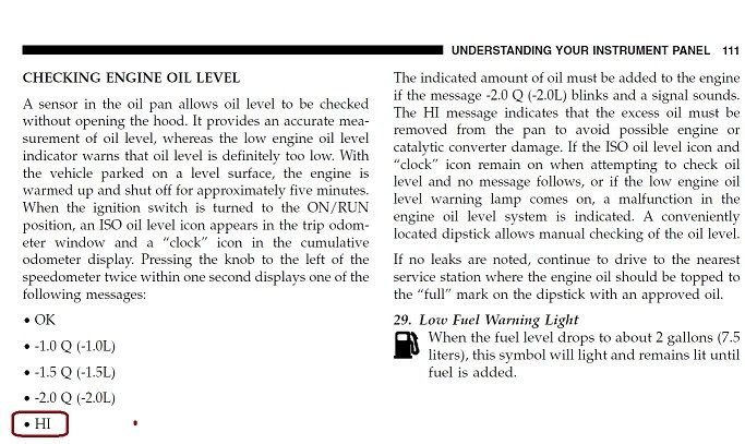

the text says , "Hl"
The owner's manual explains this:
Unfortunately, the manual is probably the cause for this. Someone read the manual and put in 8 1/2 quarts of oil at the last change. The required fill is 8 quarts.
From the often-inaccurate manual and misleading owner's manual you get the wrong message:

It replaces the trip odometer , the check coolant temp icon and the text HI . It beeps once when it comes on .
Old Aug 28, 2019 | 11:36 PM
Posts: 13,965
Likes: 1,293
Default Re: Overheating?
Yea, like I said. That's the oil level alarm.
