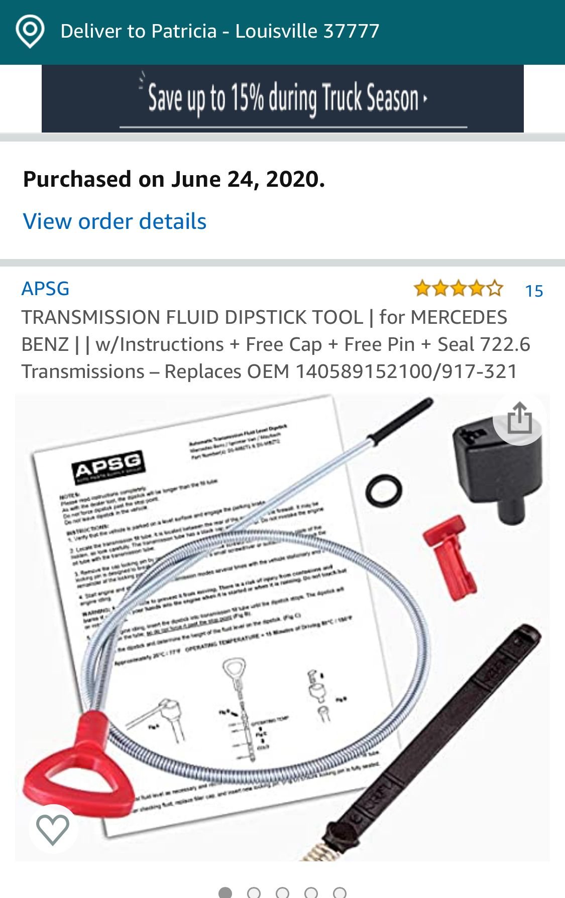

Alright, I have the part & the right fluid. Where do I find a dipstick for the transmission fluid? Any links to a cheap one would be appreciated.
Thanks!

Okay, I ordered this one... I hope that it works.
