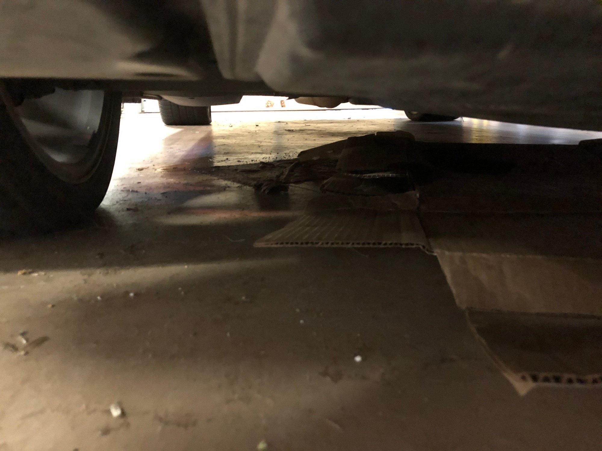

It’s basically under the passengers side seat. I’d like to think that’s the issue.
Here’s a picture of it, but, it’s kind of hard to see.

I don’t see any evidence of wiper fluid leakage... I’ll take her to our mechanic ASAP. I did drive her today and didn’t have any problems with the engine or the transmission...

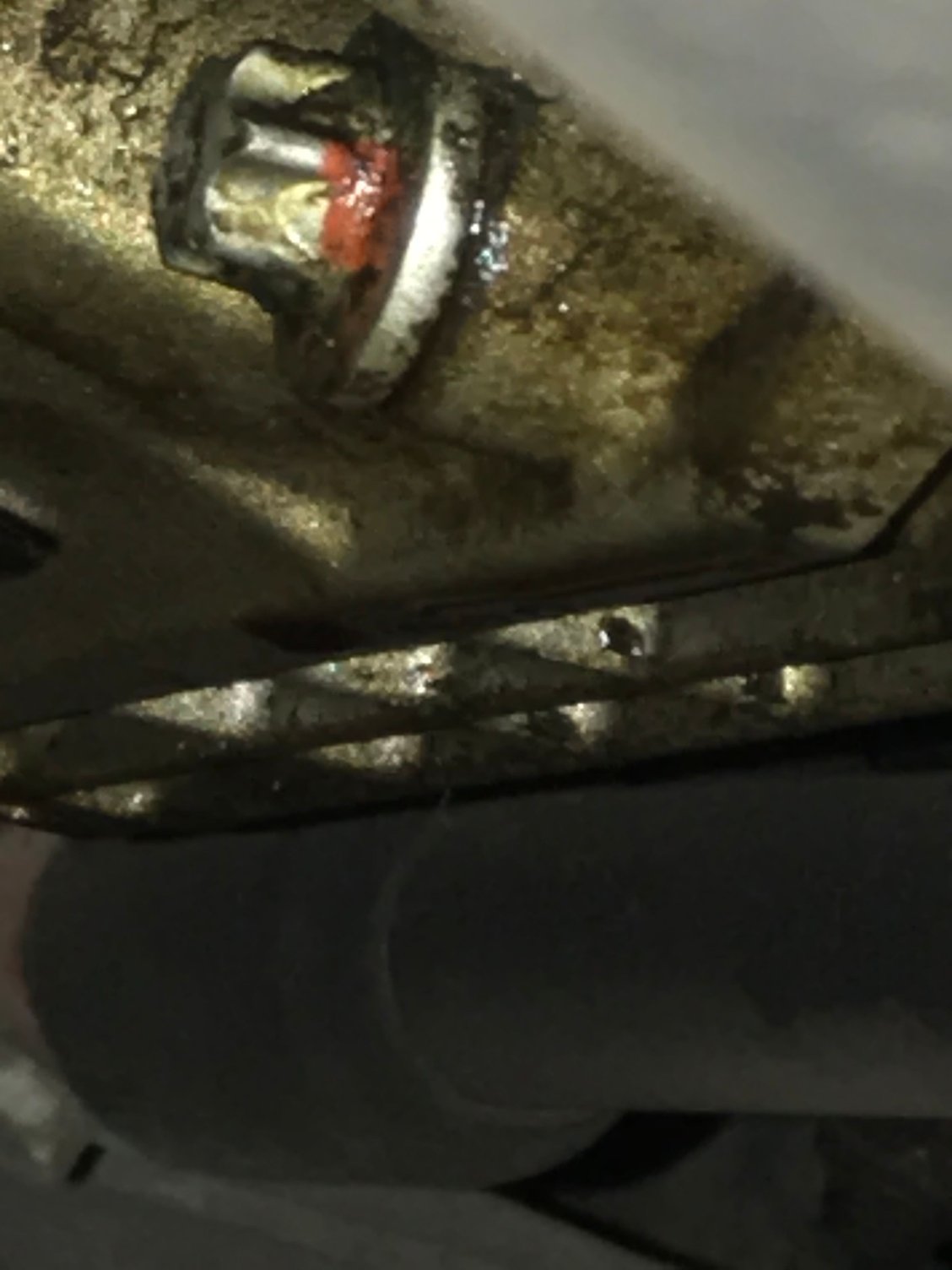

I’m pretty sure that it’s transmission fluid. It matches the stories of a few drops turning into more & more over a few months. I’ll look into that and, as always, I appreciate the information and thoughts.
Old Jun 21, 2020 | 08:19 PM
Brian P's Avatar
Joined: Dec 2018
Posts: 211
From: Knoxville, TN
Default Re: Fluid leak

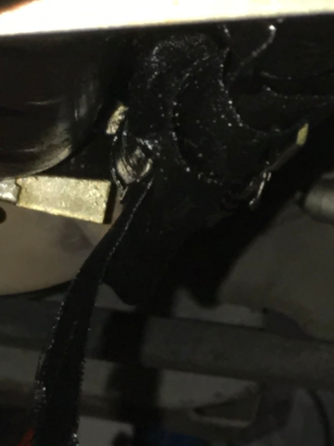

I’m almost positive that it’s the transmission adapter plug/bushing connector. Where do I find a new one or should I take it to the shop?
I also noticed that it appears that something has been shredded...

https://www.fcpeuro.com/products/mer...ce-kit-722csk1

Take a look at this. I watched
video right before I did mine last week and it was right on.
Old Jun 21, 2020 | 10:58 PM
kakenetit2's Avatar
Joined: Jun 2007
Posts: 7
From: Upstate New York
You don't need to pull the pan if you don't want to. Just the connector and add in about a quart of ATF. That kit link I sent you is perfect for that.
That’s great... two quick questions...
1) Did you lift the whole car up?
2) Any idea what the other picture shows? Is there a hose around there that has a wrapping on it? If so, does it need to be fixed, or, can I simply remove it?
3) What tool did you use to remove the part? My number of car tools are limited.
4) Anything that I’ll need to do with the computer?
Thanks!
