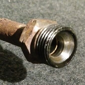

Hi,
I need to replace one of the transmission cooler oil line that goes into the radiator but no longer available from dealer. I went to an hydraulic repair shop, but they won't do that kind of work ???
So I want to make one myself but I don't know the type of fittings MB uses.
This end goes .... (This line needs to be replace)
to that flexible hose .....
And this banjo fitting to the other end of the rigid line at the radiator:
In picture 1 and 2, what type of fitting is this ? DIN, JIC 37º or else ??? Can I silver solder hydraulic lines ?? I need to find the fitting in the first picture because the banjo fitting is pretty obvious !
Thank you !

No Mercedes part numbers stamped on any of these parts/lines that might help you?

I do know the M-B part number but like I said no longer available ! I know where to buy the banjo fitting, stainless tubing, flux and silver solder (56%) but the fitting in the first picture I have no idea what it is called or what type it is ??

Try Summit racing, also determine the thread size and tube size. I assume the fitting is brazed to the tube.

Ok thank you, gonna try Summit ! If I can't find that type of fitting, I will replace that line with AN hose and fittings..... and that will be it !!!
