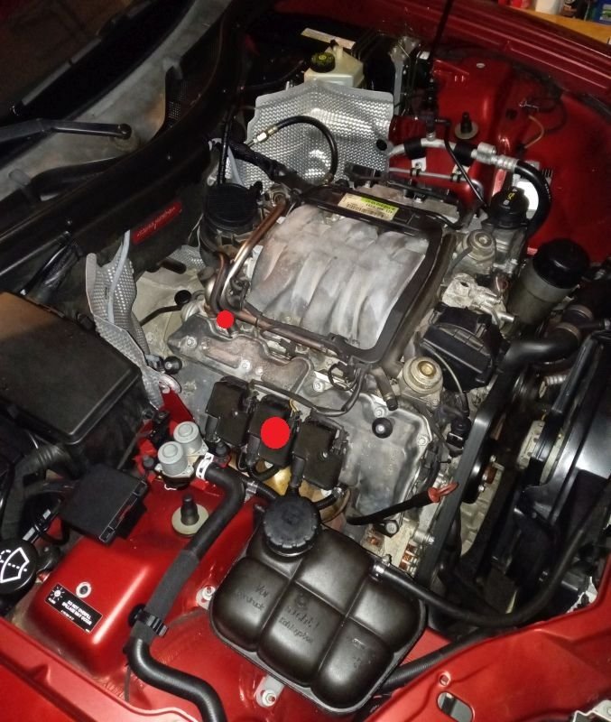

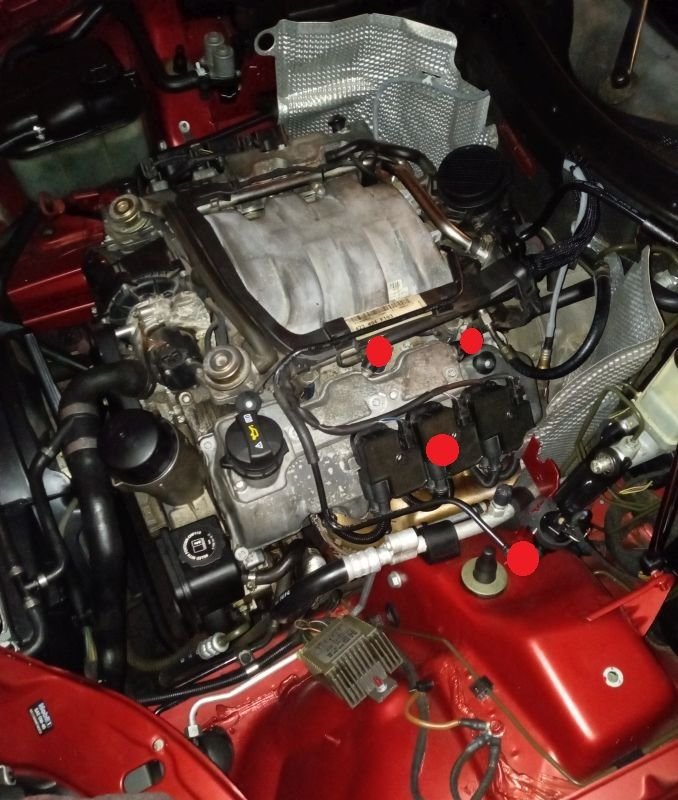

Could someone do me big favor? I'm trying to write up instructions for someone to do what I just did. I need to find the names of the parts that I marked with a red circle. And yes, three of them are on rubber hoses, one on the passenger side and two on the drivers side plus that one little connector. Thanks!
