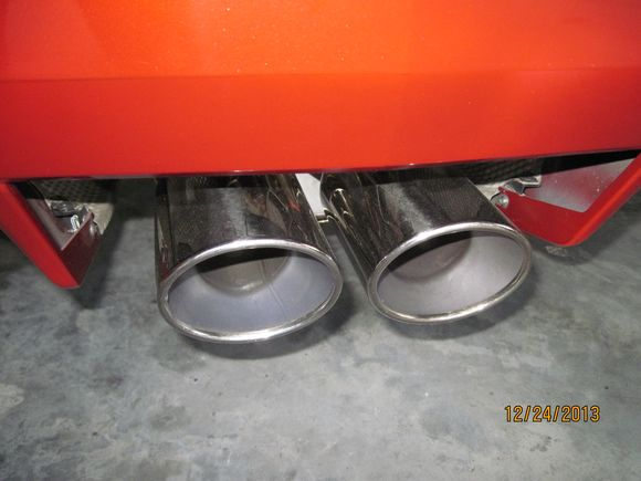

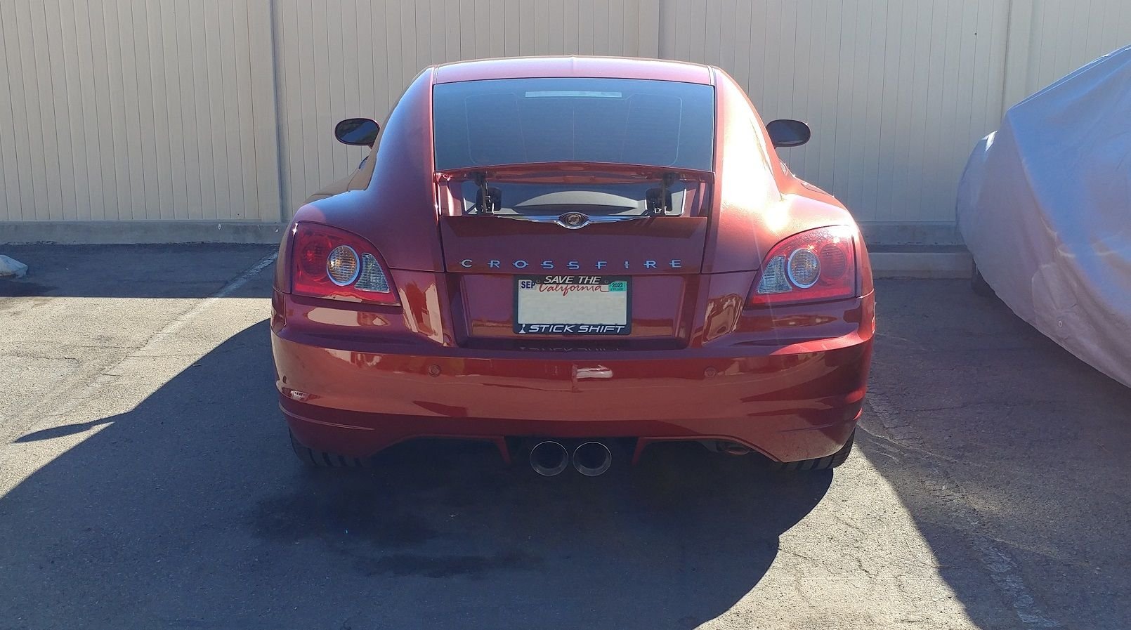

Old Oct 29, 2021 | 06:40 AM
Posts: 8,488
Likes: 854
Default Re: Got a Flowmaster Super 44, huge mistake, looking for advice?
Exhaust tips look really good on the car.
Old Oct 29, 2021 | 07:07 AM
Yes they do, very similar to Borla ( or OBX Racing )
Old Oct 29, 2021 | 09:54 AM
SD Crossfire's Avatar
Joined: Sep 2021
Posts: 126
Likes: 28
From: San Diego, CA
Thanks guys, I love they way they look. I'm not normally a fan of big tips on a small car, but they really work well on the Crossfire. That large space in the center of the bumper really lends itself to larger aftermarket tips.
