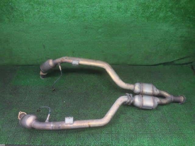

Does the Crossfire have four CATs ?

Here's a picture of the exhaust:

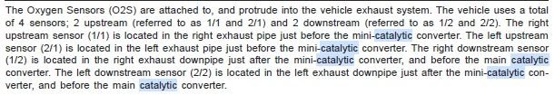

That is a great question and if you go looking in the manual it says a three way system.
O2 Sensors
And if you look at the diagram all those numbers are not listed. Sigh.
Exhaust System
You need to go to the parts catalog to figure it out.
Crossfire exhaust system parts
Exhaust system parts list
So I think the answer is yes, the crossfire has four cats.
