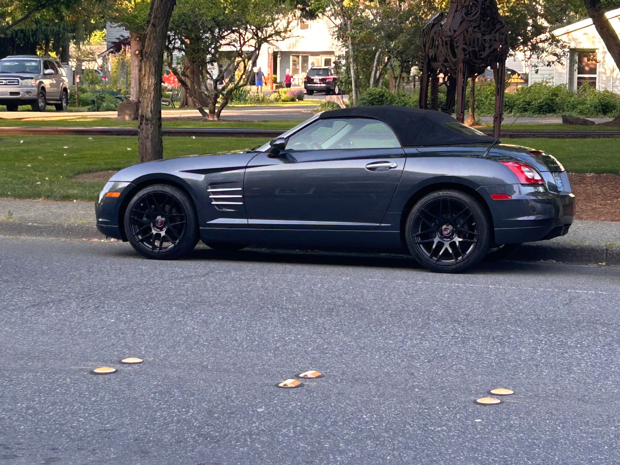

I'm new to this forum
And just bought an 08 Roadster and just wondering can the led h7s be used for high and low beam and am I correct in reading that less elsewhere will work without Resistors except for the warning light?
Thank you to all for your friendly advice
