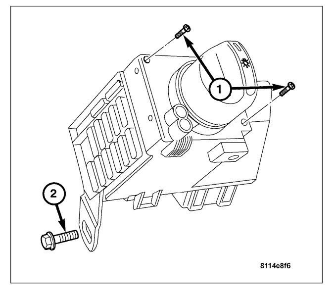

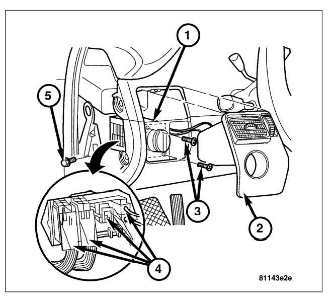

If you get fed up fitting endless resistors to trick the illumination Control Module (ICM) to think that there's not a 'lamp outage' when using LEDs, there is a way to do this that just stops the 'lamp outage' warning light from ever coming on again. Which is to simply remove the Headlight Switch (which forms part of the ICM) from the lower Instrument Panel (see diagram below) and once removed, look for a purple connector block and identify a Brown (Br) and Black (Bk) wire coming from pin 4 (for Left Hand Drive models) or from pin 5 (for Right Hand Drive models) and cut the wire and tape the ends up to prevent any shorting. This will permanently stop the 'lamp outage' warning light from ever coming on again. The downside is that you'll have to manually check your vehicle to see if you have any broken lamps that need replacing. It also save having to remove the instrument cluster to remove the 'lamp outage' warning bulb, which is another way to achieve the same result. I accept no liability if you decide to follow this theory and you should always adhere to auto lighting and safety regulations pertaining to your location.
