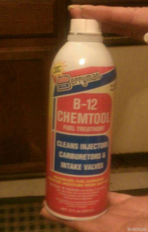

Think I'll play around with some stuff this evening.. Had a sale on luca oil gas treatment at my autozone a couple months back.. guy tossed in a bike tent type cover and some kind of hd cleaner .. it did a pretty fair job on the inside of my wheels..maybe test a little chemtool on the inside areas and look and see if I have some lacquer thinner still around..just putting on a rag and rubbing a small area to test for adhesion.

Apply to cloth..when "shiney" it's clean. Used it inside the lower lip flange and that small square of tape is there to stay now.
Added bonus.. add the rest to gas tank!
EDIT:
Also just for grins did a test with 70% alchohol..it didn't "fall" off.. but didn't actually adhere to it either. Don't know about 90% but I'm good to go with my chemtool.
