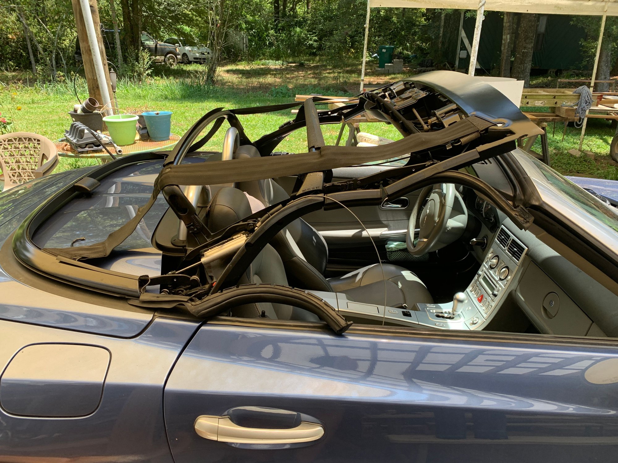

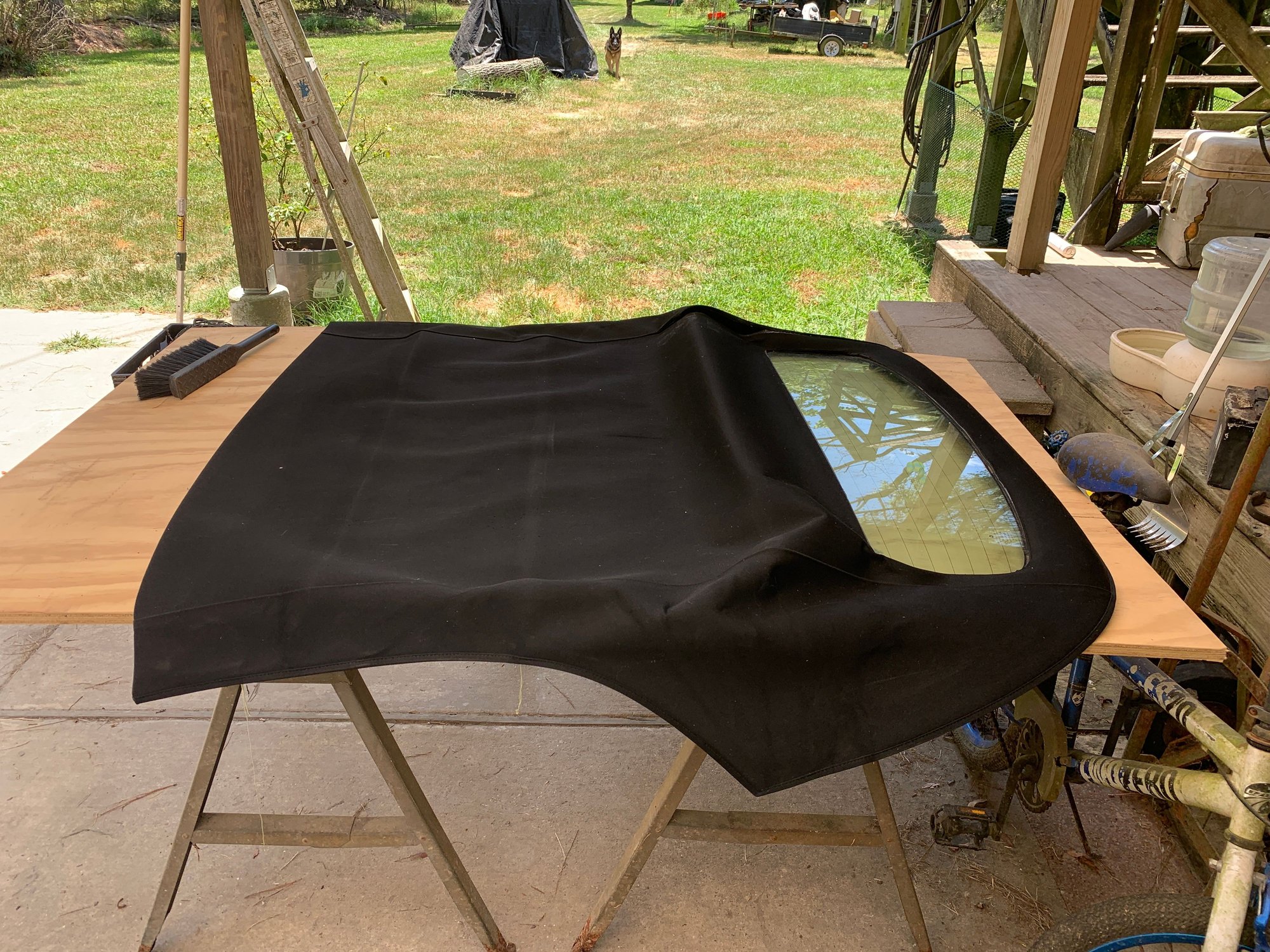

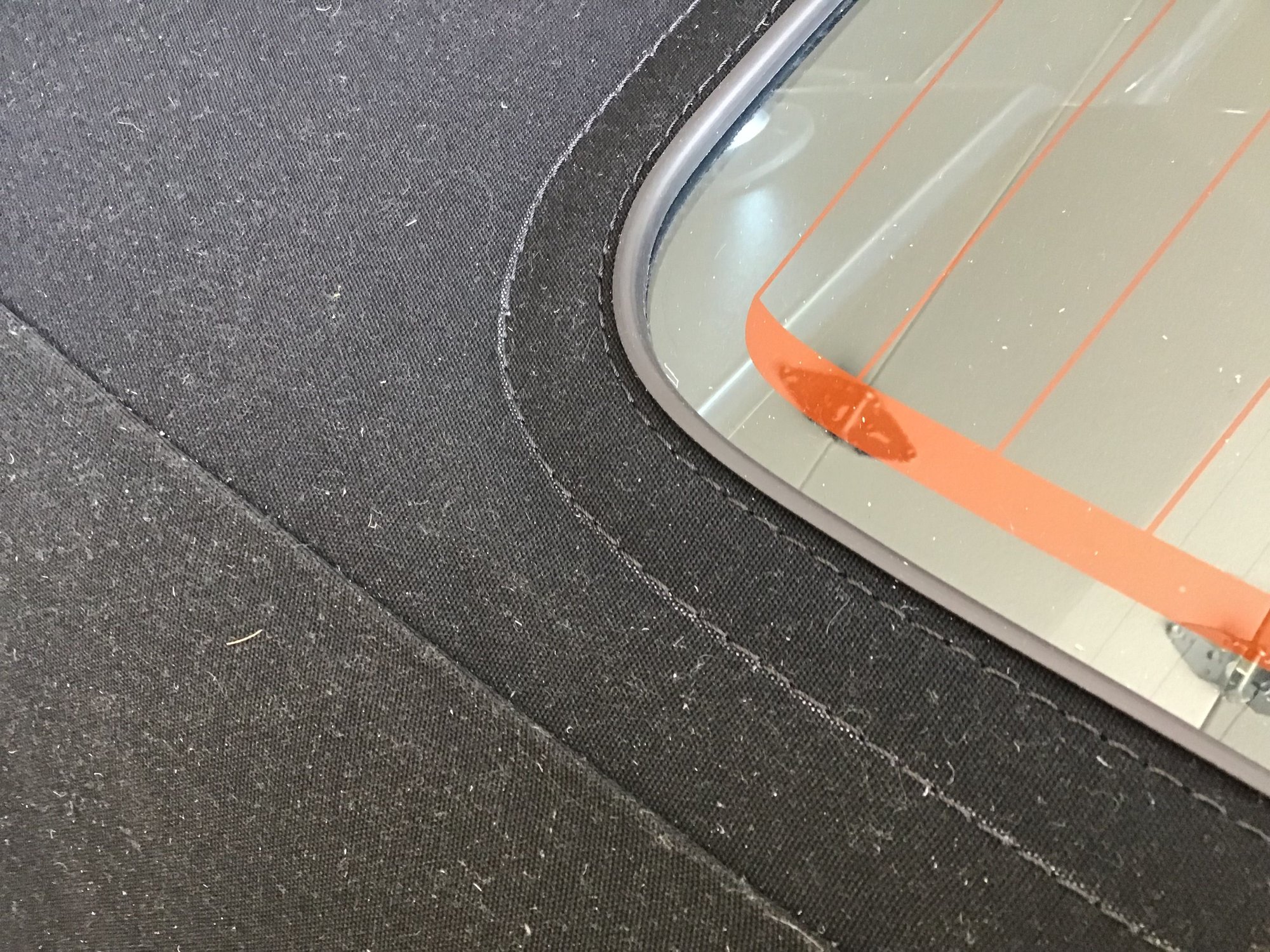

I recently bought this 07' Roadster, and I suppose the previous owner never put the top down. Because after I had cycled it about 15 times the seams on what looks like a new top started opening up. Gotta say I was pretty stunned they were only heat sealed and not stitched. Started with about 6" of the passenger side just above the rear window started opening up. My wife is pretty good with this sort of thing, but she could really only access the area next to the window.
So I decided to remove the top, after doing some research, I found some video's and some recommended "glue" for doing this. This is not my first convertible top issue, just my first Crossfire top issue. I also took care of where the window was starting to separate.
I am very surprised how well it went, but If it happens again, I think I will get a beige one from these folks. Unless someone knows a better vendor? Has anyone else had this issue, how was it resolved?

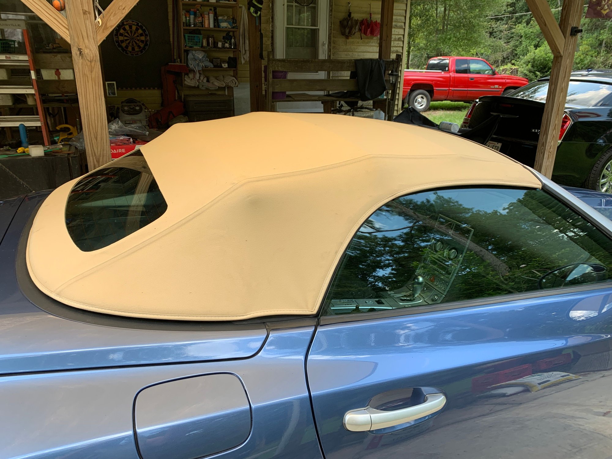

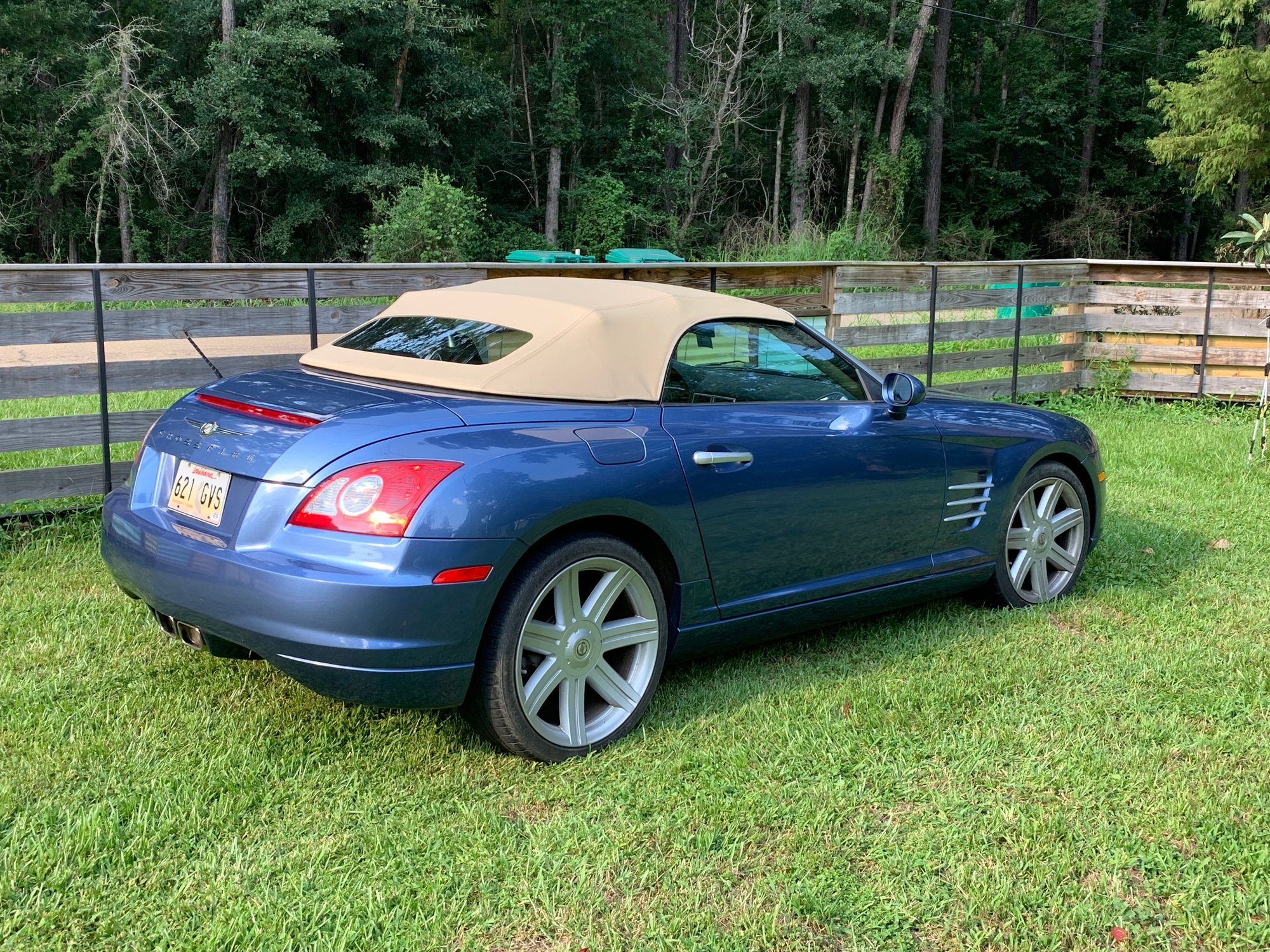

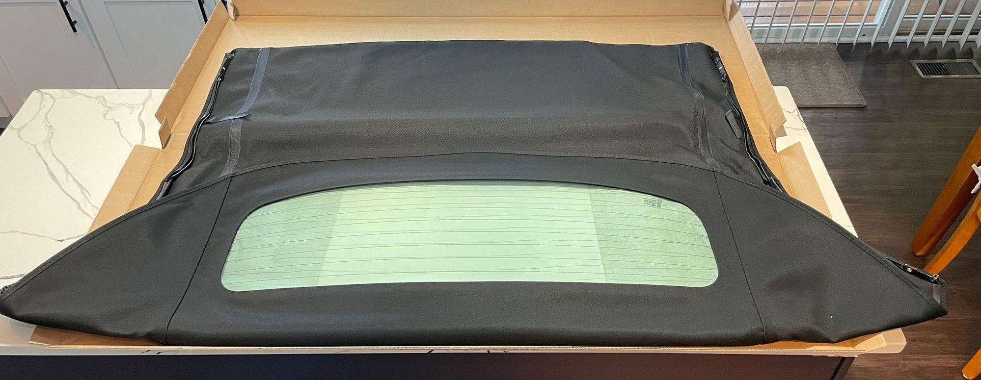

So I received my new Top from BAS about a month ago, and finally got it on last weekend. For those of you who have used BAS before, yes Becca is still there and very helpful. Anyway I decided to get the Tan Top because the black one is super hot in South Louisiana. Not sure how traditionalist might think about that, but?
Anyway, even though there were no instructions it was really quite straight forward, of course I did this last summer as well so. BTW, my repairs on the old top held up quite well, except for the window on one side was starting to open up more then I would of liked.

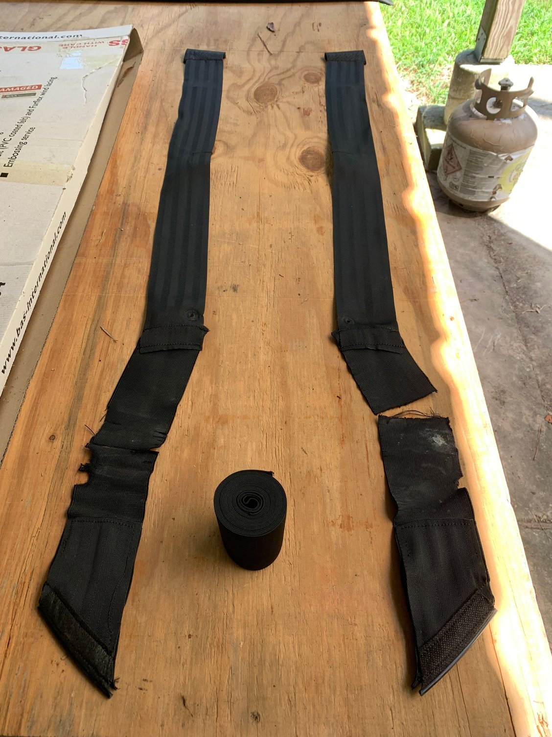

First thing I would like to mention about the finished product, it was so tight I could not fasten the front latch without the wife turning the handle while I was pressing down from the outside. Gotta say I was quite nervous, so I wrote Becca, and she told me this was normal, 4th day now and it has loosen up some, least I can fasten it myself. After getting the old one off, I had the Wife replace the elastic on the Frame Straps. All in all it only took about 3.5hrs in 96deg heat.
My Top is still having issues when left for a few days, while waiting for the Wife to finish the straps, I checked all the switches I could find (this was an after thought) and they all worked fine. Sometimes the Top works just fine, then the rear deck goes up about 4 inches and stops. But I found Pizzaguys Thread so I think we will get to the bottom of the issue soon.
Still havent figured out why/where my Batt drain went, but still got my fingers crossed.

Before the Wife reworked the Frame Straps

I like how the window is done, looks great.

That's an EZ On top (the black one in the last pictures). My car came with it when I bought it over a year ago. I have no idea how old it is. The glass is sewn in, not glued in.
I'm one of those "traditionalists" and I think that top looks great on your car! Much better than the traditional black top.
Great choice!

Tan on blue looks great! It might be tough to keep clean though.

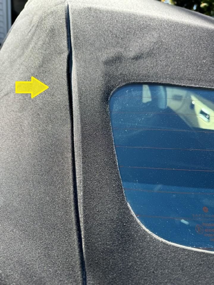

Hi @Tickfaw Joe maybe you can help me with a question.
My friend also has split seams on his convertible top. He is wondering if it is possible to glue the seams on the car without removing the top?
The obvious answer is to replace the top, but he can't afford to do this right now so he is looking for a temporary fix.
Any help would be appreciated.

Sorry John just saw this,
I dont think he can glue that, especially there.
But removing it isnt as bad as it seems. I used this video and
this glue this glue
Make sure to set the glue in the Sun to soften it up, and use a good Calk Gun.
He will need to drill out 8 rivets and replace them, the rest is really quite simple.
Take care, Joe
