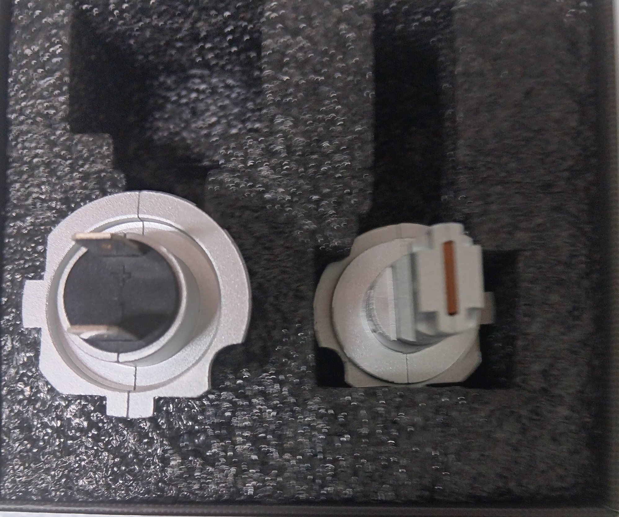

Has anyone use the SEALIGHT LED light bulbs?
I ordered them and am assured by the company that will work with the XF. The new bulbs are their X5 model.
Now the question, Instead of a single tab on the unit it has 2 tabs 90% apart. I am replacing H7 bulbs with a single tab.
I called the company thinking this must be a simple question for them to answer, but no they had no idea.
So has anyone else had this issue of which tab to use to line up in the housing.

OK, I will try and post pictures of the light bulb. So sorry about the size of the image. I am not that computer literate. As you can see there are 2 tabs 90 degrees apart. Should the light be mounted vertical or horizontal?
Thanks in advance.

but there are 2 tabs on the bulb

You will note in the picture that there are 2 tabs. One would place the light in a vertical position and the other in a horizontal position.
I have changed bulbs before with regular H7 Sylvania bulbs with one tab.
The company says these are the right bulbs but do not specify proper position of the tab.
I will probably send them back.
I am desperate for more light.
I see what you mean, you are talking about the actual lamp inside the housing as it is flat and will either sit horizontal or vertical based on the tab location in the housing. That would concern me as well. Maybe, try both and see which one gives you the best light pattern. The seller should know which direction the actual LED segment sits inside the lamp housing, it seems. If you don't get an answer from them, yes I agree you probably should send them back. Good luck!

Thank you all for all your input
When I called them, they had no idea.
I was sure that there would be a simple answer from them, not to be.
I am going to send them back.
