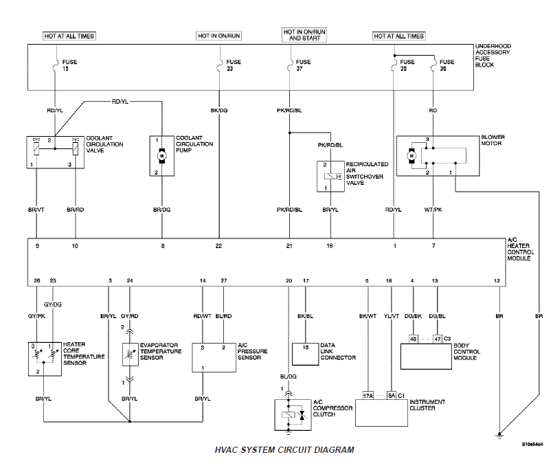

How do you go about engaging the clutch and lubricating it as well? I currently have the problem of my clutch not engaging and my fan only comes on when its required to keep engine temps where they should be. Any help would be most appreciated. Thanks in advance
Old Jun 23, 2020 | 11:57 AM
Default Re: A/C Pre(?) season system inspection/check?
Only help I can provide is the schematic and to check the connectors internal to the HVAC control module.
( you probably know this, the HVAC control module is the thing with the dial and wheels and AC button.

Yeah that's my current problem, no engagement of the clutch while turning on the AC. I'm probably going to have to eventually have someone look at it. I've tried almost everything it seems and no progress and still no hard evidence on what's the root cause. Quite frustrating as I usually able to fix mostly everything on my car, but AC/Heater systems is the least of my knowledge. Hell I've felt like I've learned a hell of a lot more about it though in the last three days than in my 21 years of driving lol.
Inside the black plastic box that holds the RCM, PCM and BCM there is an electrical connector mounted on the front of the big box. That connector is for the AC compressor. You can bypass the control module input/safety limits and test the compressor clutch by directly applying 12v jumped from the battery directly to the compressor at that connector. If the clutch engages you know it is a safety switch/low pressure problem or control module problem. If the clutch does not engage then it is the clutch compressor problem. I've forgotten what color the wire is, but you can see it in the wiring diagrams in the service manual.
Sorry if this sounds novice, well it is for men with this type of stuff but what do I use to apply the 12V? Also on the battery is it the positive or negative terminal I jump it from? Thanks in advance
Old Jun 24, 2020 | 07:03 AM
The positive (red ) one and BE CAREFULL !!!
It's best to connect the wire to the clutch connector, NOT THE GROUND SIDE then touch the other end to the positive terminal.
The other way, you are carrying a HOT wire around many ground sources. Burns or fire can result !!!!
You use a short piece of wire. The wire on the car is 18 gauge so just about anything you have laying around will work. I use a number 12 gauge solid wire as it is stiff, insulated and easy to work with. I checked the wiring diagrams and the wires you are concerned with are Blue/green coming from the A/C control module inside the car. When you take the connector apart you will see in very small numbers the pin designation. It is pin three male coming from the A/C module, connecting to the female which runs to the compressor clutch. The wire on the female part of the connector looks black to me. Simple take your wire put one end into the female socket in the connector and place the other end of the wire on the positive post of the battery. No need to start the car or even have the key in the ignition switch. You will hear the clutch engage when you make contact with the positive battery post. This is much easier than trying to get down to the compressor and fiddling around in the tight spaces down there as everything is up topside and easy to reach. Added benefit is it test the wiring from the connector to the clutch at the same time.
